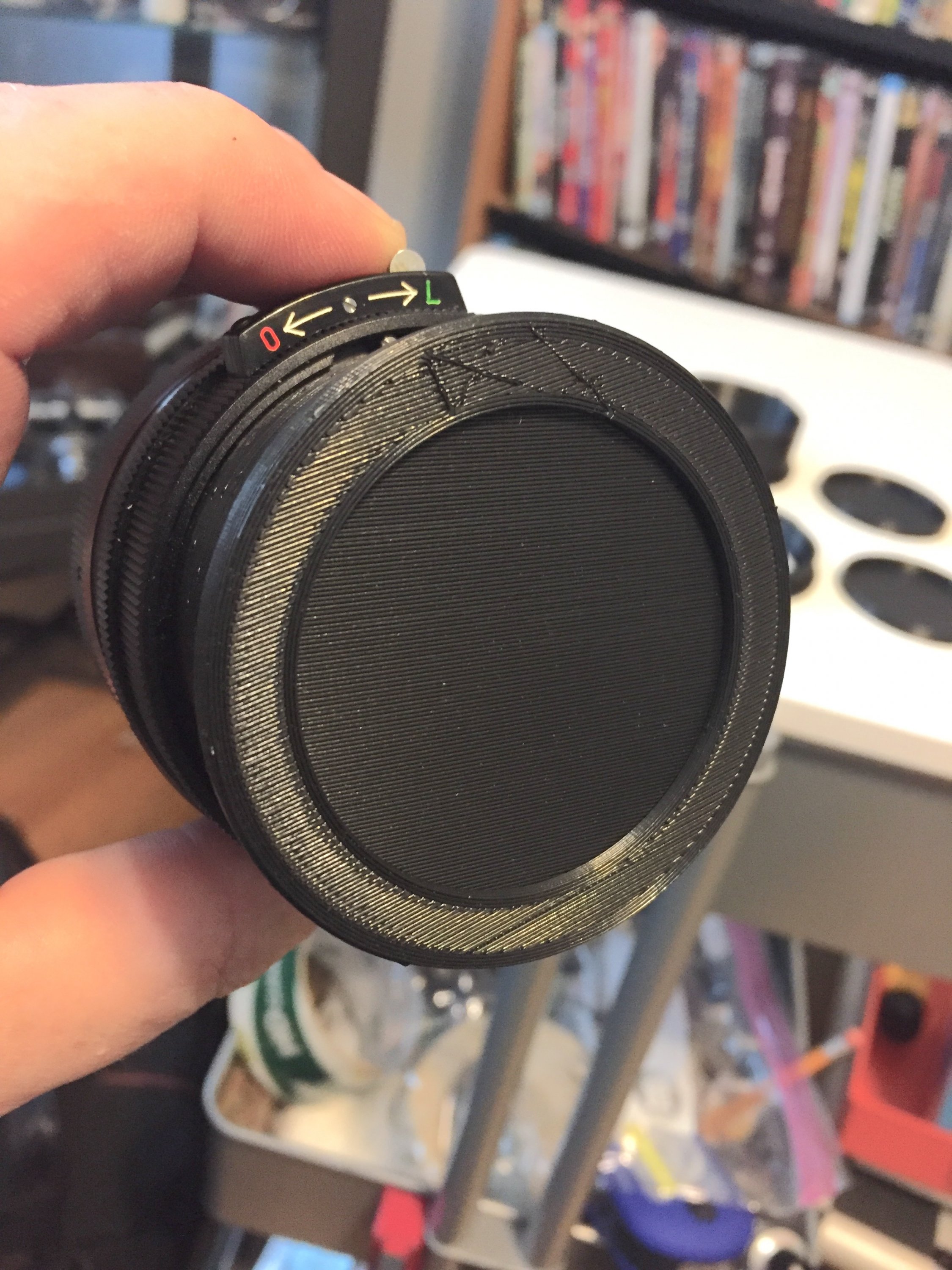

Here's a great resource for those hard to find Vivitar TX unmounted lens caps.
Stu Jenkins uploaded these files on Thing Verse;
Short Version: https://www.thingiverse.com/thing:2795791
Long Version: https://www.thingiverse.com/thing:2795793
I had 2 of each printed out by Ringing Anvil Armory of Huntington, West Virginia for a very reasonable price and with a bit of filing (as indicated on plans), I now have lens caps for all my Vivitar TX mount lenses in the unmounted state.
Here is are the unassembled lot and the one tall cap I have assembled.
59398759789__A89FE174-9A72-4710-92B4-395E9E861B27.jpg 59398767214__3D230D40-26D1-4883-9FF0-5B63A7F2DEF3.jpg 59398769098__1D6D821B-0EBD-48F8-B53E-4E8AD6F8D3EE.jpg
Now, as long as I find a TX adapter for any camera body I collect, I can avoid having to also collect a pile of lenses to use the body.
