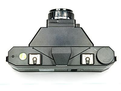

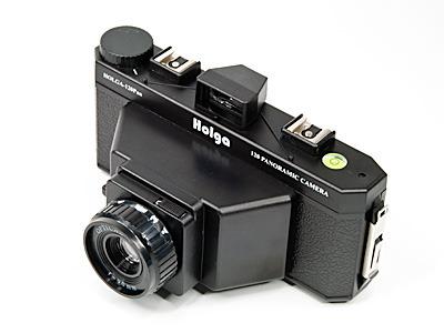

This body isn't very deep. Will you make a cone for the lens (or pinhole) for better coverage of the film plane? Otherwise there will be significant fall off on the sides of the negative. Do you know the design of a Holga 120PAN?

A red window and a cone will be added next.
I have used a Holga 6x6 for some basic dimension of the film compartment.
It will probably look similar to the 120PAN when complete.

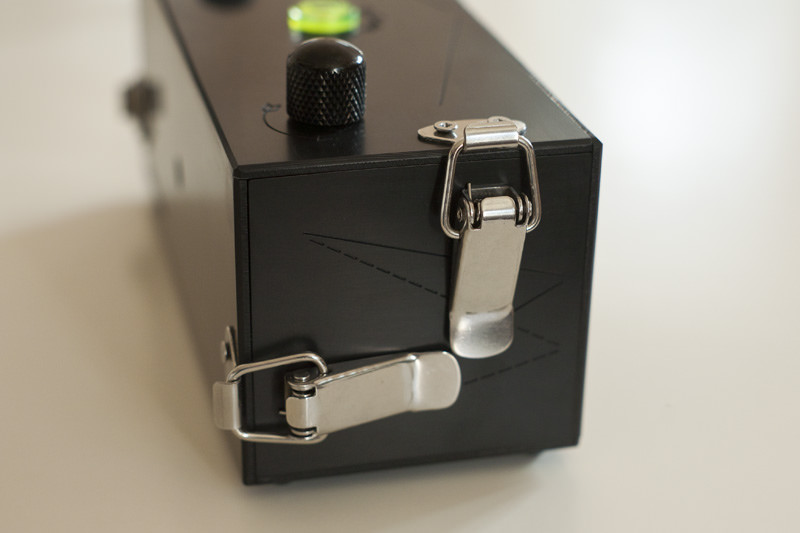

A little more progress
Back lid with light trap
And I ordered some small latches to keep it in place.

Made some design tweaks, added some cold shoes and a bubble level.
