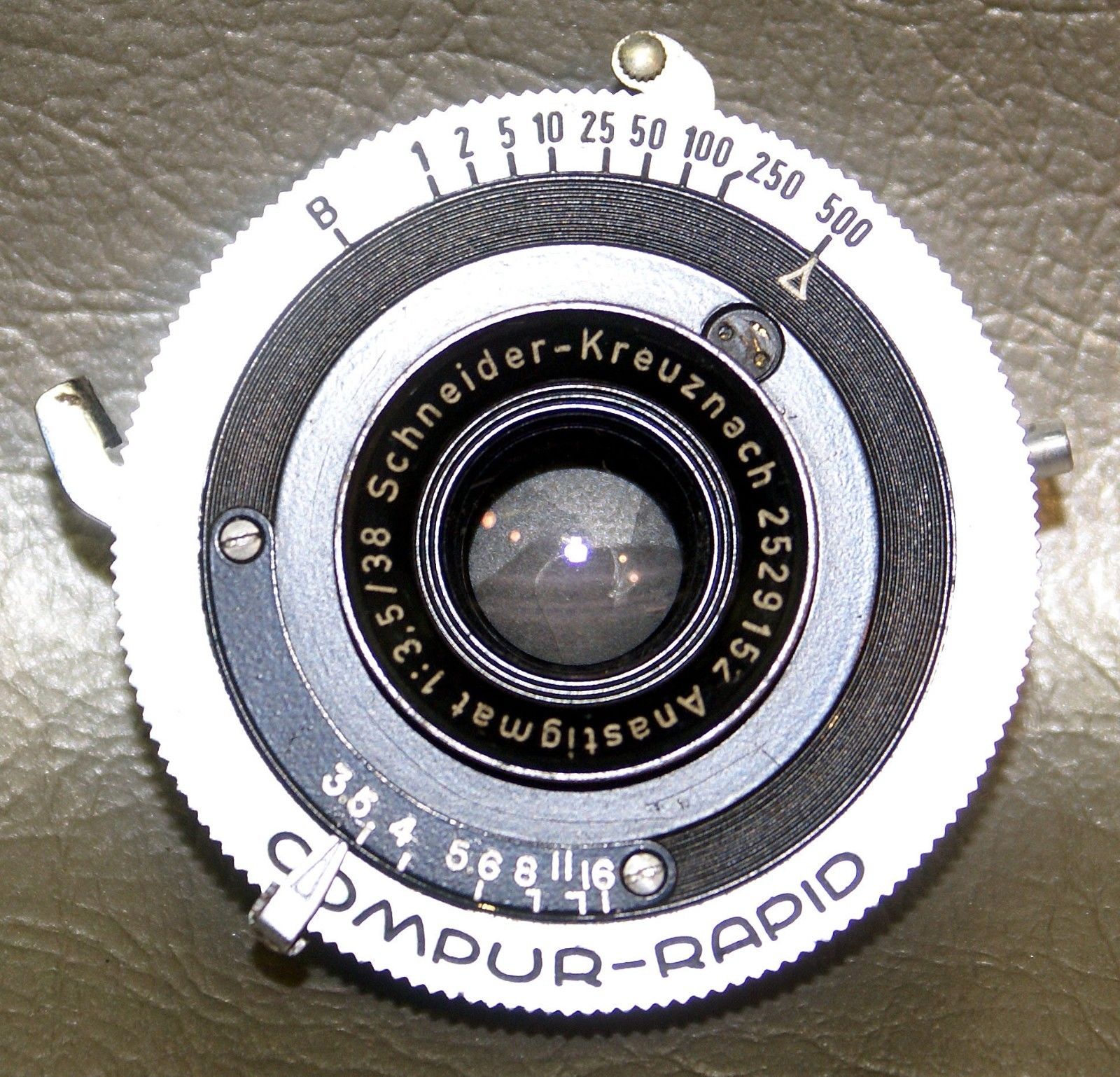

I have this 38mm Schneider Anastigmat in Compur #00 shutter and I have no clue what it's from. Maybe an old folder? It might cover 135 format but perhaps only 24x24mm or half frame. Does anyone know about this lens? I bought it for the shutter but I want to know if I'll make a grievous error if I remove the cells and toss them. BTW, google found nothing.

Do the obvious stupid thing. Ask the lens whether it is a triplet or a tessar. Count reflections. Either way its nothing special.
Front: 4 reflections, all strong
Rear: 3 reflections, 2 strong + 1 faint
Xenar by another name. Nothing special and absolutely not a wide angle lens. f/3.5 tessar types do well to cover their focal lengths.

The production notes say it is a Xenar, made for Goldeck. Goldeck is actually a type of 6x6 made by Goldammer, so the lens would would obviously have been for some other Goldammer project. They also made a 4x4 and a 16mm camera but I haven't been able to find anything that would use a 38mm lens, although a half frame camera would seem obvious. There were around 600 units produced for them in a few batches in early 1951, so whatever it was may have disappeared with little trace.

The 38mm f2.8 Xenar was normally in a Compur or Prontor 00 sized shutter it's probable yours was made for a Goldeck 35mm camera I'd guess with a similar square frame format to the Tenax, Agfa Karat and Rapid cameras, also later126. There's no way it would cover full frame 35mm properly and definitely not 127 (4x4) or 120 (6x6).
Goldeck did make some 35mm cameras, they aren't as common as their 6x6 and 16mm cameras, one went unsold earlier this year in the UK, the photos have gone from the Ebay listing infortunately.
