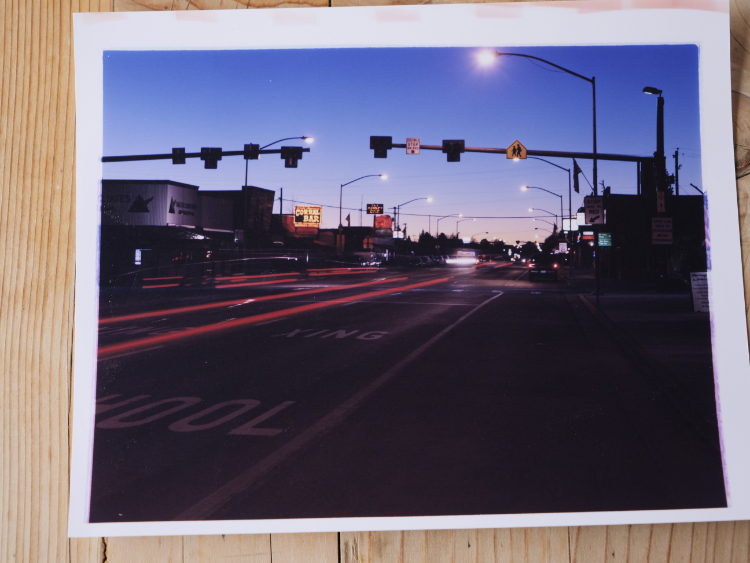

Anyway, here are my first two color prints in 37 years using a process I understand. More enjoyable this time around.
Portra 160 (6x7 neg), Arista RA-4, color tube processing, 75°F. 70Y/40M.

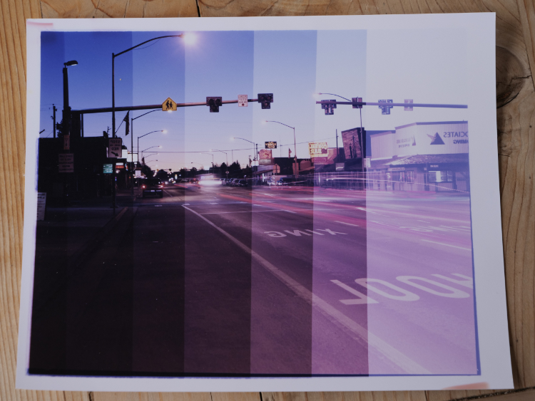

One thing that might help in your printing is to make a different type of test strip. Make four different exposures onto the paper using the same exposure time, but change the aperture instead. There will be a slight color shift as the exposure get longer and this method will show different exposures without any color shift. Minor, but might be of value.

Thanks for the suggestion. I was happy enough to get these two prints made - I had very little time. I was in such a rush you might have noticed that the neg was flipped in the exposure test! I hope to carve out some real time to really dig in.
