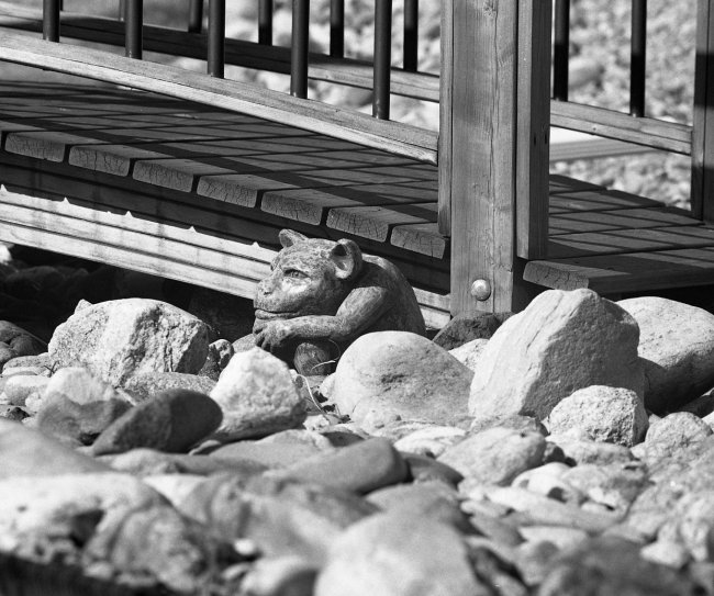

This was shot with the 360 Graham. On Delta 400.

I'm amazed by how sharp and contrasty my 360 f6.3, non C version is. Sure I have to shade the front element properly and all exposures are from the top of a decent tripod. But that is routine for all my Mamiya RB 67 photography anyway.
Another virtue of the long focal length is the seriously thin depth of field available for portraits and close-ups when using 0.25D and 0.5D close-up auxiliary lenses.
