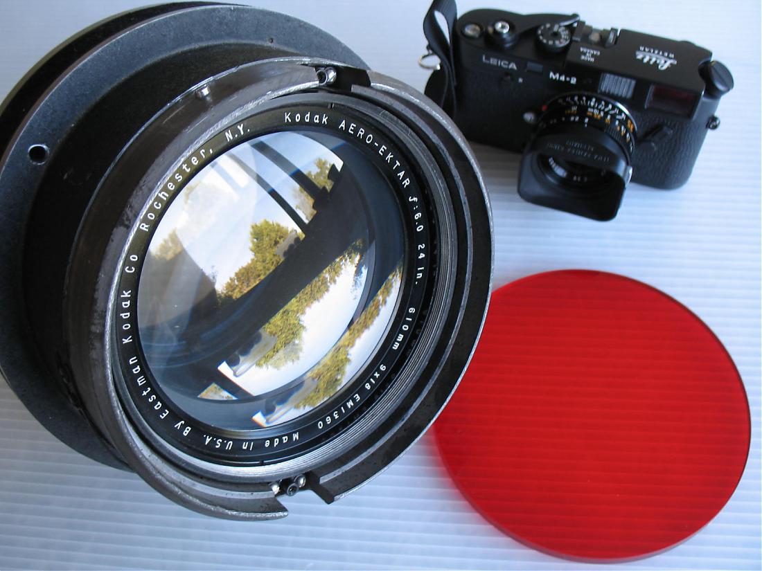

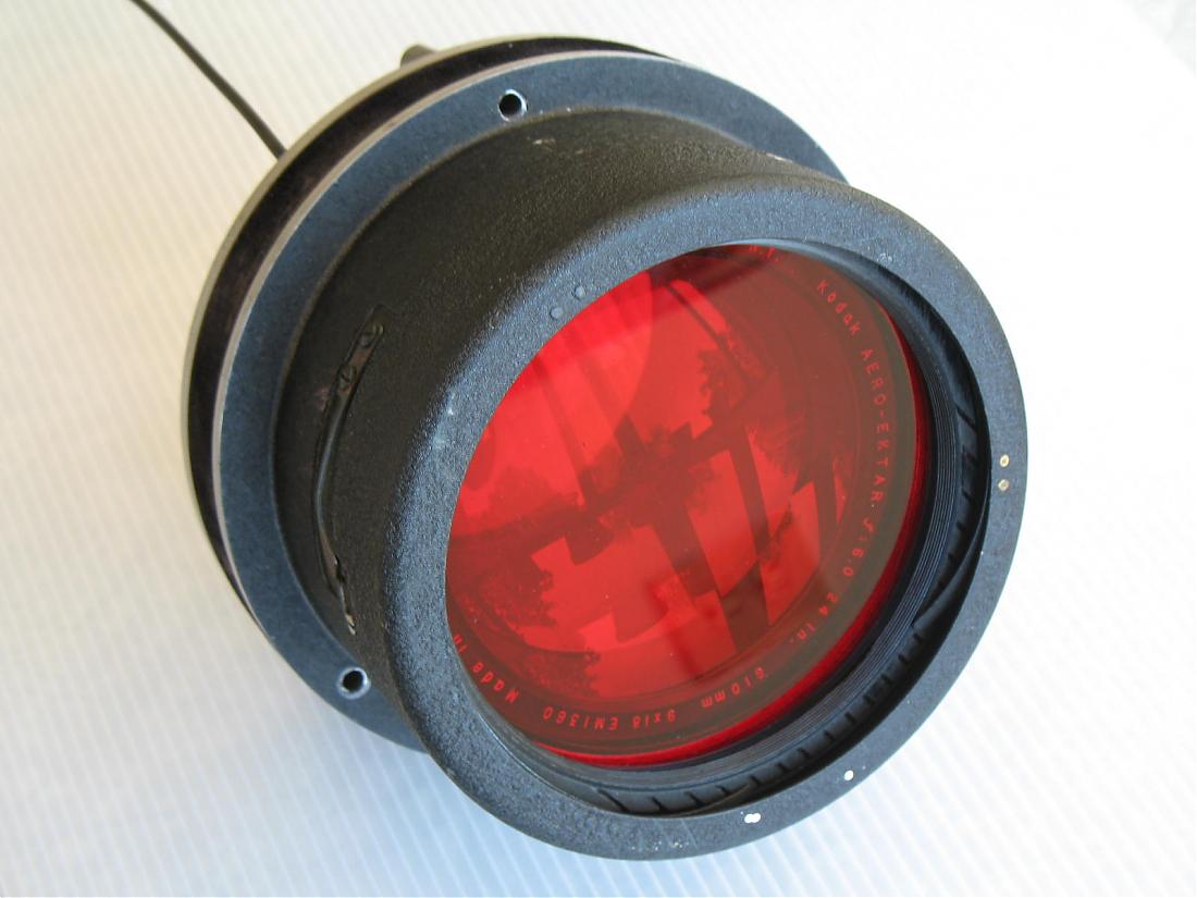

Here's a photo I just dug up from my 24" f/6 Aero-Ektar I just sold with 35mm camera for size comparison.
