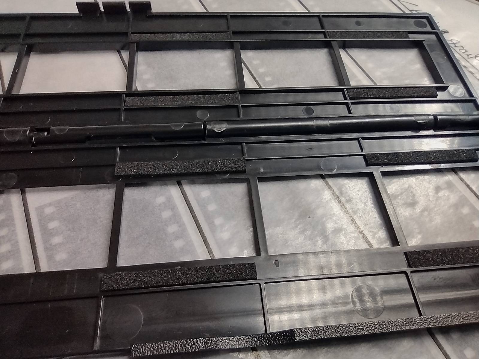

My OM1 takes negatives that align perfectly with the negative transport tray, but as warned in the manual for the film scanner there may be non-standard cameras that misalign them and you should just crop the image. My OM10 unfortunately does this, though I doubt it's really non-standard, it's probably just not trying to follow the standard that the negative transport is inadvisably built to. Additionally and separately, the scanner cuts off the last 1mm of the negative which really messes up some compositions.
I fixed the sprocket misalignment and eased the inappropriate cropping of the bottom a bit like this: I used a suitable blade (Stanley/exacto/craft knife) and pushed it against each sprocket protrusion until it pops off. I then cut 8 small strips of thin light seal foam and placed it in opposite positions in the lid and base so it squeezes the negative into place when the lid is closed. Best to only do one or two frames, leave the remaining 4 free of foam so the negative can be positioned and handled easily: less is more. It takes slightly longer to load the negative but it fixes the alignment issues, and can help a bit with inappropriate cropping in the holder, because at least you can vertically centre it which works sometimes. It would be better if it overscanned, then you could do sprocket holes, but I suspect a medium format scanner may be required eventually.
