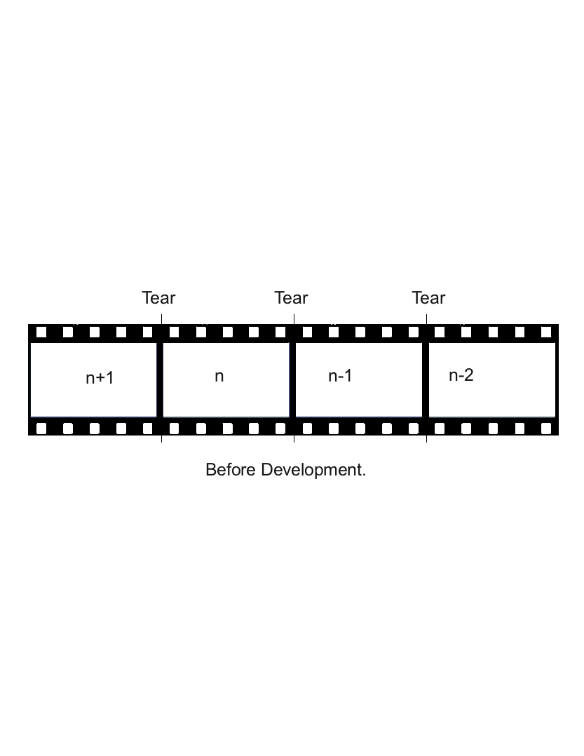

The simplest solution would be if film manufacturers have the film manufactured in a way that it can be teared into strips before development, so the zone system is also applicable to roll films. But, it will require to align the film between tears.
