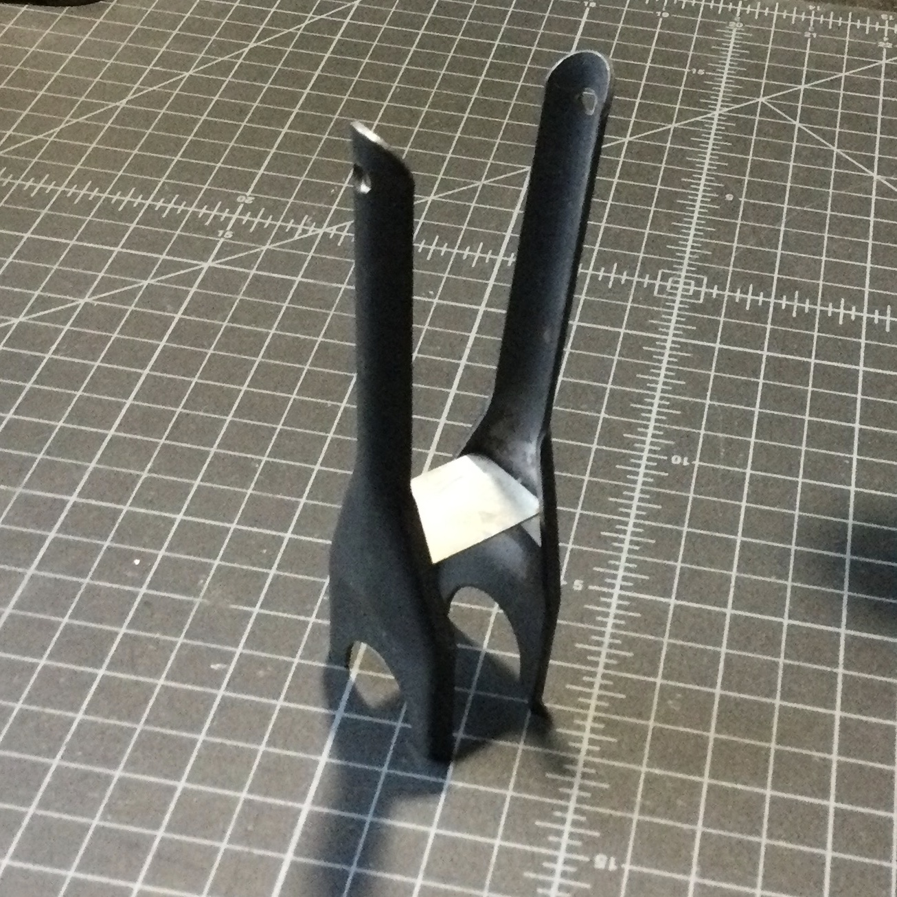

Interesting! What method did you use to open them without damage, and how easy was it to reuse them? The more info you can provide, the better. Thanks.
This just may be the most underrated post in this thread.
I used the gizmo pictured below, but once I got it opened I discovered it snapped back together just like a Kodak Snap Cap. That gizmo is better than a bottle opener as far as not damaging the cassette. I have film re-loaded in all my cassettes now so I’m not going to try opening any but I think you can probably pry it open with your fingers like you would do with the snap caps.
edit: I just easily opened and closed one in a changing bag with my fingers.
