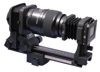

I'd go with the bellows instead of the extension tubes. The slide stage fits onto the front of the bellows and your lens is in the middle.

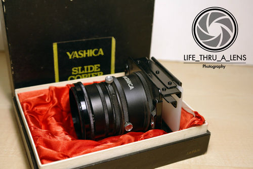

Yashica did make this unit with built in optics and no bellows. This fits right on the camera in place of the lens.

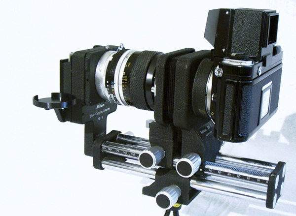

Once, I routinely used a Nikon PS-4 Slide Copy Attachment and a 55mm f/3.5 macro lens reverse mounted on Nikon PB-4 bellows to copy slides. To make negatives for black & white printing, I used Kodak High Contrast Copy film (ISO 8).
However, I stopped using this setup when I bought a flatbed scanner that allowed me to batch-scan up to 24 slides (mounted or unmounted). Today, I only use the PS-4 set-up when I need to make slide-to-slide copies.
http://www.flickr.com/photos/11336821@N00/7072654453/

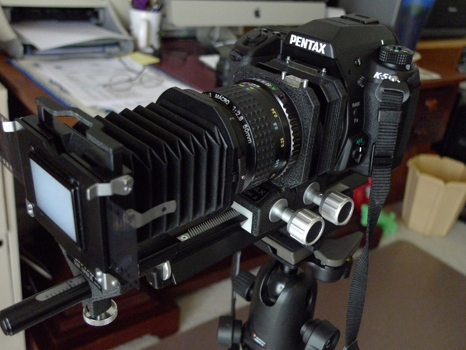

This is my setup for copying film/slides, and to also digitize them. Pentax DSLR, or any other brand DSLR or SLR. Bellows with slide attachment holder and marco lens. I can also reverse the lens for a flat field effect if I need to crop more than 1:1. I also have a Plustek 7600 film scanner, and this Pentax setup matches or beats the Plustek, plus it is much faster.
Wayne

Wayne, that is one cool set up.
Thanks, I have been looking for a holder for 6x6 so I can do the same thing with larger negatives. They are hard to find. If a person is interested in copying slides or negatives to digital or film, I advise looking for this setup. Bellows for all camera makes were/are available on ebay, and the prices are low. I have had this setup (for a Pentax film camera) for over 25 years.
Wayne
I see you are using a Pentax DSLR+50mm macro+Autobellow+Slide holder which is what I have too. However, I even have to crop less then the visible area of the mounted slide let alone achieve 1:1. I have tried all the possible combinations and cannot achieve focus. Of course I can achieve 1:1 with any of my Pentax 35mm bodies but the only way I have managed to get 1:1 with a DSLR is to use one of my zoom lenses between 70-70mm. Can you tell me what lens you're using to copy slides and are you getting just the cropped area from the mounted slides or 1:1 on a full frame of 35mm film? TIA.
Oct 1, 2011
171
DeLand Flori
I do have a slight crop with the K5, but if I rack the lens all the way back and squash the bellows flat, it is very little. I get probably 90% of the negative area, which is usually ok for what I need.
