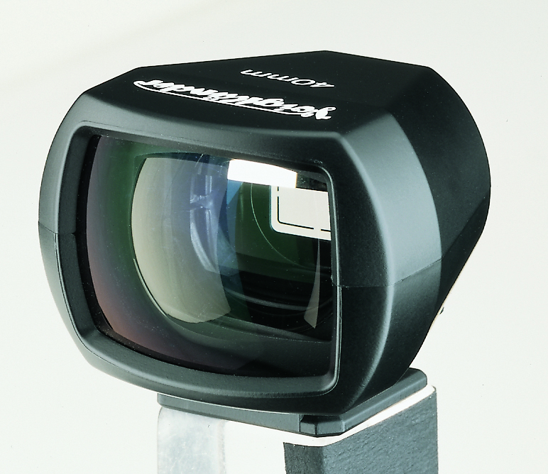

On my rangefinder cameras, I only bought lenses which had matching viewfinder frames in the camera. In your case why would you not just acquire one of these:

I don't like secondary finders... I am aware they exist, have used them and don't like them, the finder with rangefinder patch is where I do my business or the screen of SLR or LF camera.
