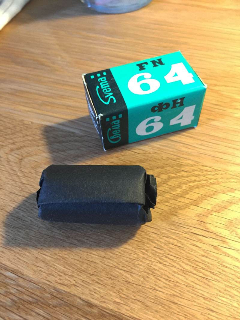

First post here but I really need your guys help.
I bought some soviet era film on ebay (images attached) and it came to me in a current usable state with my 35mm. The film is expired, which isn't an issue, and wrapped in black cardboard paper to block out light. IT is just the film rolled without a canister.
What I need is a way to get the film into a 35mm film canister so I can use it with my 35mm. I live in Brooklyn so would love to get someone in New York to take care of it for me rather than buying some equipment that I will only use once + I don't have regular access to a blackroom.
If anyone knows of any place that could help me out in New York that would be amazing, if not a direction to look would be helpful as well.

Welcome to APUG
What is missing is what we call the "cassette".
That what you bought was a so-called "re-fill" pack.
You won't need some special service, But
-) a cassette that one can take apart (eg. "reloadable cassette)
or
-) a standard cassette were a short end of film is still sticking out
-) a piece of sticky tape
-) room that you can get absolutely dark (eg. a inner bathroom with a towel at the floor in front of the door)
I leave it at others to describe the rest. (depends how that refill is wound...)
You could for example go to BH and get one of these:
http://www.bhphotovideo.com/c/product/86473-REG/Kalt_NP11137_1_35mm_Cassette_For_Bulk.html
Then in complete darkness:
  • open the cassette (twist the top cap)
  • take out the spool
  • unwrap your film (remember, complete darkness)
  • tape one end of your film to the spool in the cassette
  • wind your film onto the spool
  • stick the spool into the cassette, allowing a bit of film to stick out of the felt gate
  • replace the top cap
Complete darkness is hard to come by, most apartments don't have a suitable room or closet. A changing bag (a bag made of lightproof cloth, with openings for your hands) is an alternative.
So you go to Adorama, B&H, or some other camera store and buy some reloadable film cassettes Dead Link Removed and a roll of scotch transparent tape. You can open the empty cassette in daylight but the film must be handled in total darkness. Load the cassette(s) as stated in post 4.
A fresh cassette is very useful to look how the spool is orientated to the cassette casing!
This is important when sticking the film to the spool.
One should expect the refill wound that way that the end part is at the outer.
