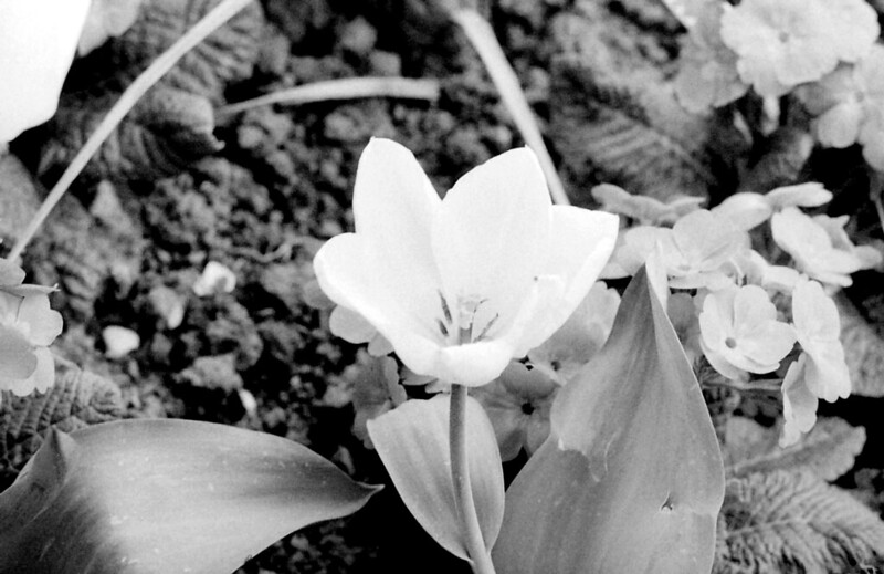

Here is Fomapan 400 in Fomadon R09 (Rodinal)
4-15-2016_038 by Ricardo Miranda, on Flickr
