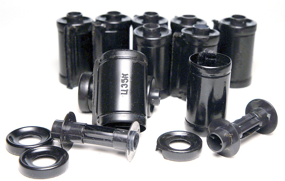

When you guys talk about Russian/Soviet/Ukraine metallic cassettes, this is what you mean?
Yes. The light trap is made from a lovely plush.
In the Worker's Paradise 35mm film was sold as lengths of film wrapped in foil. The photographer went into a dark room loaded the film into cassettes by hand. I imagine the film was taken in for processing again wrapped in foil.
It seems that a Glorious Five Year Plan rather overforecast the need for cassettes as there seem to be lots available. It is one of the few photographic items where the Land of Progressive Socialism produced a better product than the Decadent West.
Yes. They are typical Sovjet era quality (or lack thereof). They are unevenly manufactured, A tight fit in some cameras. If you buy NOS, they come wrapped in some chemically treated stinky paper.
If you use masking tape to label your rolls, the tape will pull off the black paint.
I guess you can say that they do their job, but seeking out ILFORD metal cartridges from the 60/70's may well be cheaper and give you a better experience.
I found 20 ILFORD cassettes in the classifieds here from someone in Germany. They ended up cheaper than the batch of 10 I purchased from Ukraine 2 years ago.
