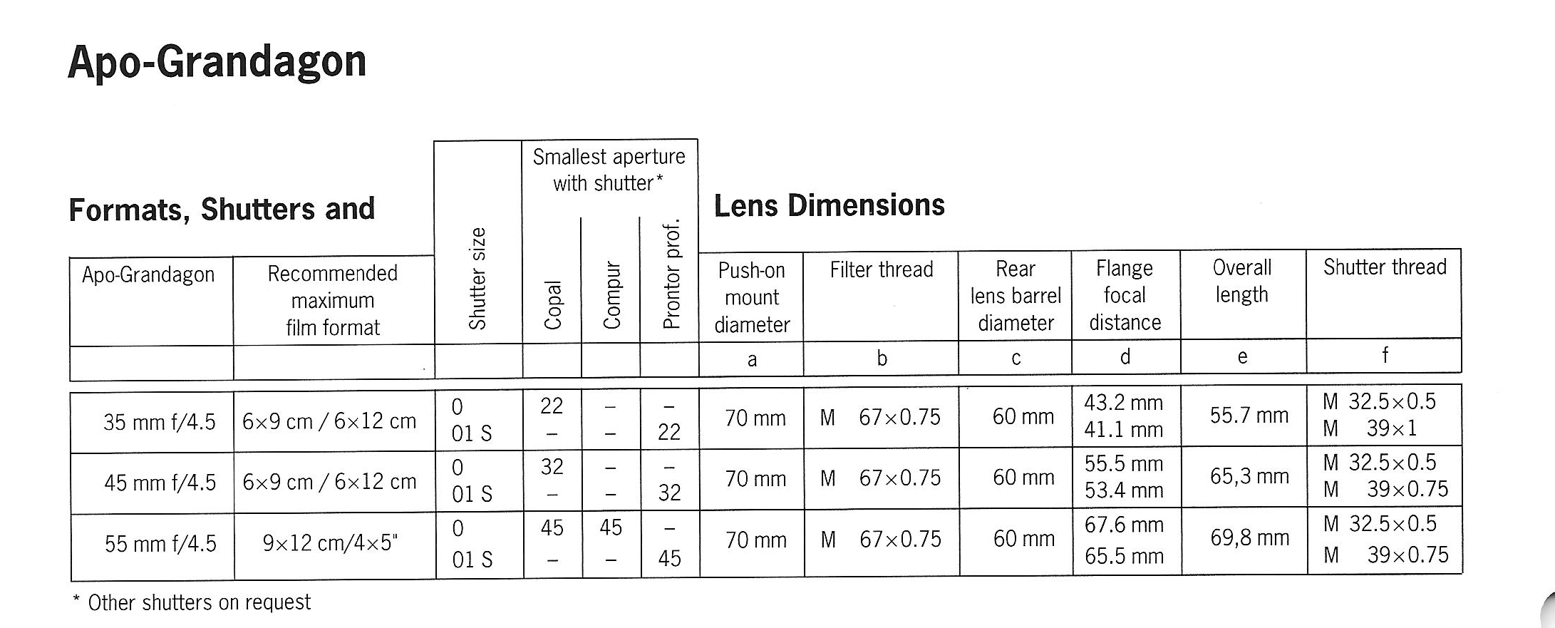

The 4.5/35 APO-Grandagon with an image circle of 125mm is rated to cover the 6x9 format.

Mine doesn't do that. You've shown us a scan. Is the negative like that?
FWIW, Rodenstock recommends shooting the lens at f/8 - f/11.
Fair question, but yes, the neg is like that. The scan is off a Flextight, so film flatness at output is not an issue, and I just rechecked it with a 15x loupe. I only have a 6x9 enlarger, so it's not the end of the world if 6x9 is the usable area. If I get more than that, hey, virtual shift function.
But your point about recommended apertures may be the key; maybe this is on the other side of where the performance is good. Might also explain this hefty 0.9 center filter, which when I tested it against 5 others, was the only one that actually did anything. Maybe I got the wrong impression that this could be stopped down from some old Rodenstock data showing the image circle for various lenses at f/22.
In theory, at least, coverage should not be an issue; a Horseman "6x12" back is only 113mm wide at the film gate, so it's a 125mm image circle. Linhof 6x12 is actually 120mm wide, so no, it wouldn't cover that.

Leigh, there are two coverage concepts floating around. One is "illuminates." The other is "has good image quality in the corners."
You used the limit set by mechanical vignetting as the limit of coverage. That's the illumination concept, I think. My 35/4.5 Apo Grandagon puts light in 6x12's corners. Beyond them, in fact. By your criterion the lens covers 6x12.
By the way, mechanical vignetting is worse at large apertures than at small.
Please look at the Rodenstock apo-grandagon grandagon-n data sheet that's posted here: https://onedrive.live.com/redir?res...35&authkey=!AESpkw0t4oWnLtY&ithint=folder,pdf In particular, look at the 35/4.5 Apo-Grandagon MTF and illumination curves. Per Rodenstock, it gives reasonable image quality at 63.7 mm off-axis. In words, it covers 6x12.
Per R'stock, illumination falls off approximately with cos(theta)^4. Worse than at f/4.5, which points to mechanical vignetting, better than at f/11. At the limit of coverage illumination is down 4 stops from the center, as cos^4 predicts. In words, it covers 6x12. That falloff is better at f/11 than at f/4.5 explains why R'stock recommends stopping down at least two f/ stops when using the recommended center filter. Two center filters are recommended for Apo Grandagons, AR Center Filter + 2.5 E67/86 (the first offered) and Center Filter + 2 E67/86.
Dante, which filters are you using? That image quality varies with the filter used suggests a problem with at least one of your filters.
Make sure that both cells are fully seated in the shutter. Attaching and removing a filter shouldn't move the front element, could unscrew the front cell a little.

Obviously this ocultation effect varies with the diameter of the aperture.
That's why the image circle diameter increases at smaller apertures.
This is the illumination concept. The reason that image circle increases (image quality in corner concept) as lenses are stopped down is that off-axis aberrations that are sensitive to aperture get smaller as the lens is stopped down.

Dante, thanks for the reply. Neither of your filters should cause the problem. That the results you get change depending on which filter is mounted still bothers me.
What happens without a center filter and which do you use? I found a CF necessary when shooting 2x3 with E6, can't imagine shooting 6x12 without one. I mean, 6x12's corners are 4 stops down from the center without a CF.
If you're not doing anything silly like shooting handheld you might want to have a qualified shop look at your lens.
I hope that Bob Salomon will jump in. He used to recommend Marflex, who are now closed, as the R'stock service station in the US. I think that Nippon Photoclinic in NYC replaced Marflex, could be mistaken.
