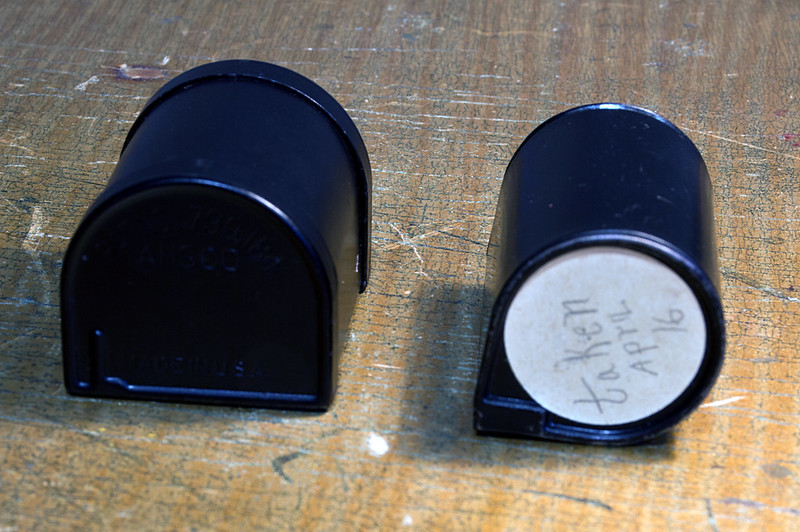

The Ansco Memo cartridge holds 24 exposures, while the Agfa Karat cartridge holds 12.
The Karat cassette and its successors can technically hold more film, but the system necessitates the camera to block releasing after a certain number of exposures, as the film end can't be fixed in the cassette.
For one reason or the other one decided on 12 exposures.
That is 12 @ 24x36mm, more at other aspect ratios with successor cameras.
