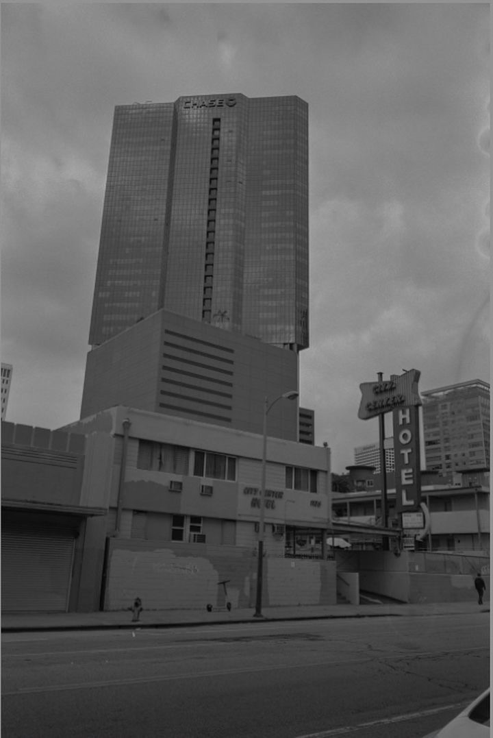

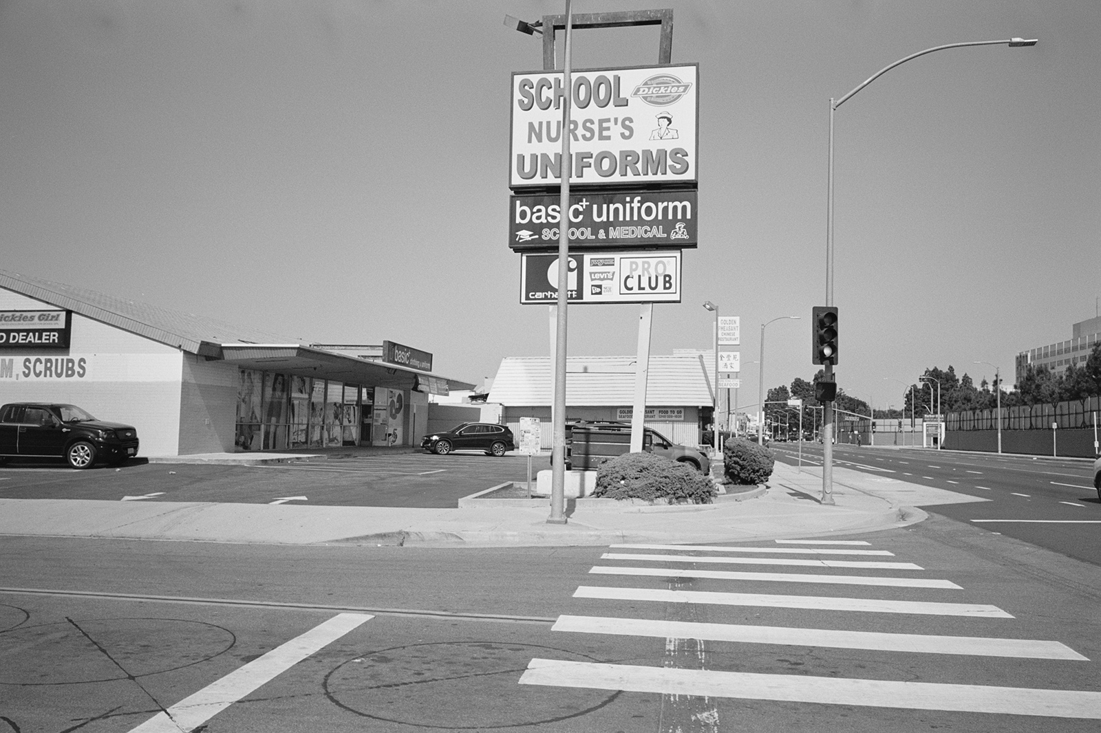

I've been shooting 35mm XP-2 which is black and white but is processed in C-41 chemistry. I've been taking it to a supposedly "Pro" lab in Los Angeles that uses dip and dunk chemistry.
In my sky areas I'm getting what looks to me like developer marks from chemistry, I'm not familiar enough with C-41 processing to know what's causing it, I just need to find a lab that doesn't cause this. It looks like it has something to do with the sprocket holes and the agitation...though it's not like the surge marks I remember.
Does anyone on here process 35mm C-41 regularly with a lab they can suggest that gives clean skies? Like maybe Praus, LTI, CRC, Or maybe Richard Photo Lab in LA?
Or am I being unrealistic - is 35mm with an even tone sky always going to show inconsistencies like this? I know it's not light leaks in my camera because it 100% does not show up on regular b&w film I process myself.
some examples:

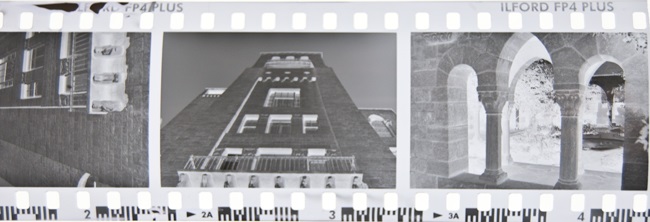

Any chance you could post an image of the negatives, something like this, please? (so we can compare the negative to the scan positive)
A correctly run lab should not cause surge marks on 35mm film, no matter what equipment they use.
If it was surge marks, then in a dip & dunk machine it would suggest excessive nitrogen burst (over agitation) in the developer.

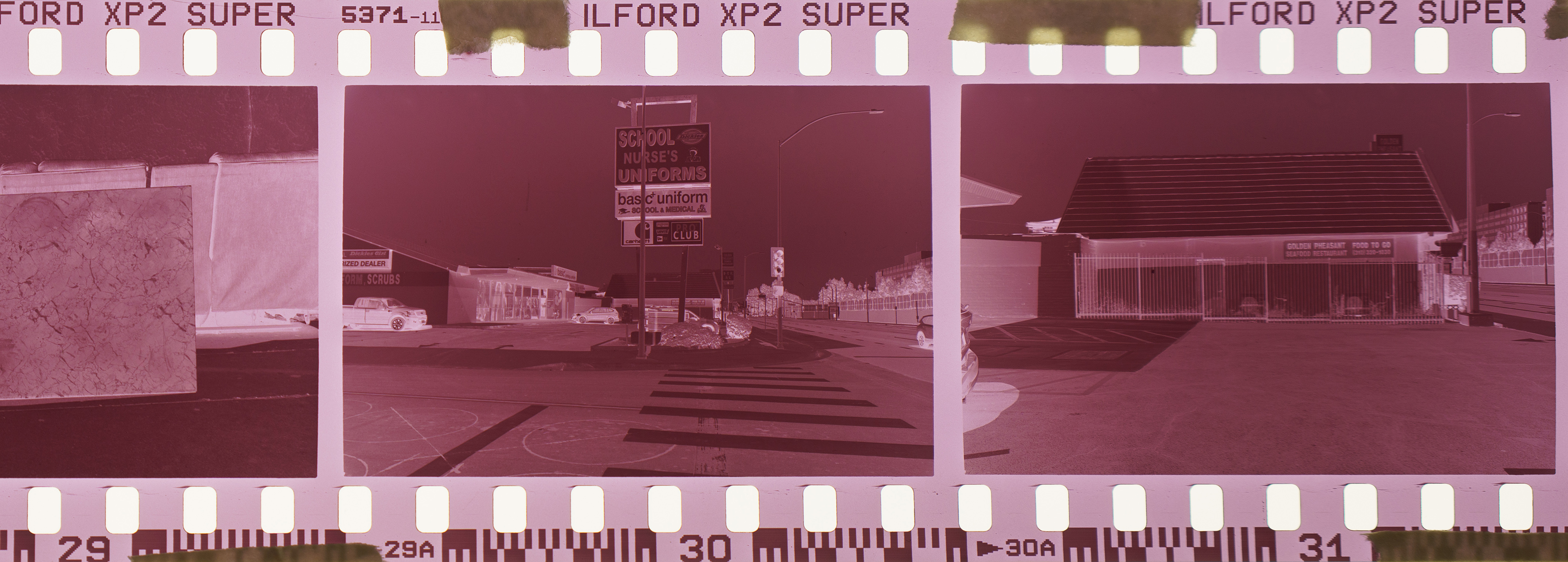

Btw, I can indeed see the unevenness issues in the negative. Sure looks like a processing problem to me.

Thank you for posting the image of the negatives. I can barely see unevenness in sky in the negative strip. I don't see any surge marks either.
I zoomed in and on the bottom sprocket holes, there is a mark on the top left of each sprocket hole. Does this appear on other negatives shot with this camera?
I can barely see it myself. Somewhat surprisingly though, the areas of increased density aren't adjacent to the sprocket holes, they are adjacent to the spaces between them.

Here's the center frame from the photo of the negative strip, inverted and with boosted contrast:
Note the low-density (negative) anomalies along the top edge and how they compare to the first version shown int he thread.
