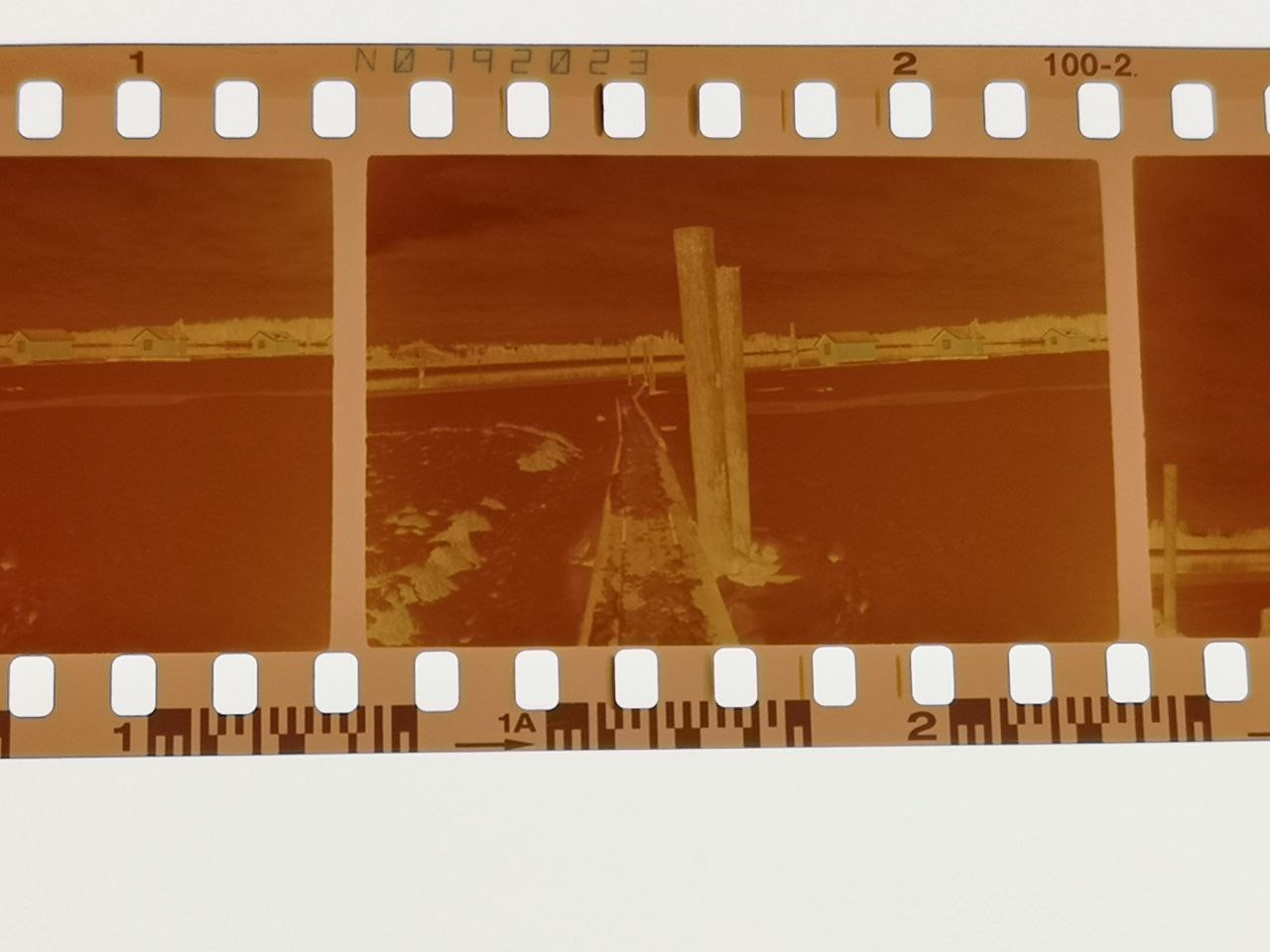

this is a roll of 35mm Lomography color 100 iso, I had in the fridge for a while. Lomography buys a diversity of old stocks, their 120 rolls are usually easy to identify from the edge markings.
But this I have no idea, the 100-2 ie. 100-N number reminds me of some Kodak.

that is where Kodak puts the serial Number on their rolls.
Now does that mean they packaged it, or that they made it? Who Knows.

AFAIK, only Ferrania Technologies originally, until they shuttered, then Kodak until presently, supplied film for Lomo for their Lomography Color Negative 100. What you’re showing is not the Ferrania, which had their • + and triangles on the negative edge, and a slightly different hue to the mask. That’s Kodak’s mask color, and also how Kodak identifies their emulsion generation on the negative rebate. Looks like Kodak Gold Gen 2, which was somewhere in the ballpark of what Kodak was reportedly supplying to Lomo.

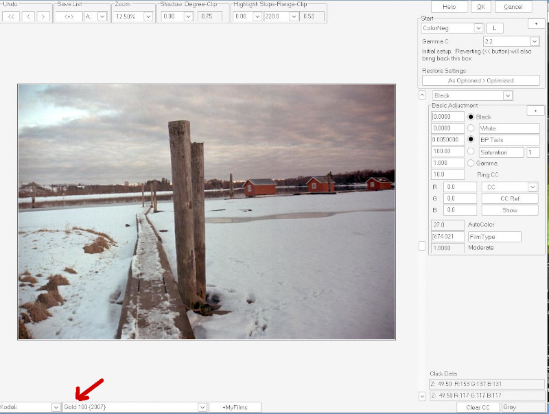

having some clue about the emulsion can make things easier when doing scan->positive inversions. I use ColorPerfect and it provides a list of presets by brands/emulsions which I find often a good ground for further tweaking if needed.
in this case I was testing the behaviour of a 70's/80's zoom lens from an obscure brand (Kamero...).
In ColorPerfect I chosed the "Gold 100 (2007)" profile and the 2nd frame of the negative in previous post gives this:
there the sun is setting to the left of the shot, we see CA, besides some vignetting occurs at wider focals with this zoom.
I could keep this profile as a ground for color modifications or try another one. Then decide to play a bit more with this lens, with a shade next time, in order to know what use I could have for it, C41 or BW.
But then it's good to have a ground for conversion of a whole roll.

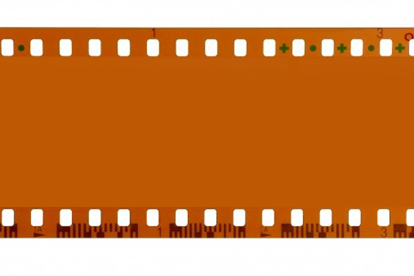

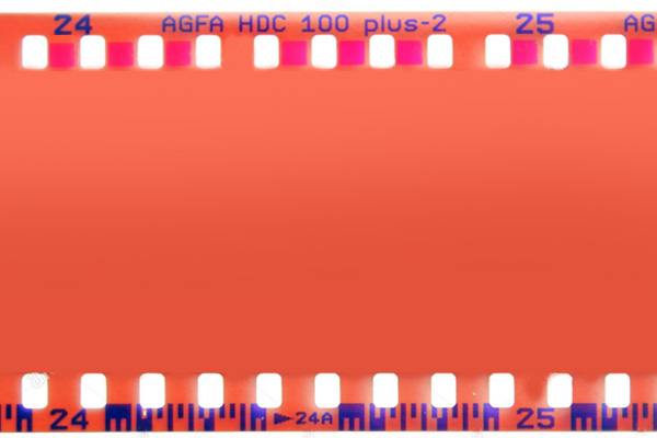

Here are a few samples of different film edge markings.
This is Kodak. Note the arrow under the 7A, the same as in the image posted by the OP.
Agfa
Ferannia
Fuji
Of course some of the edge markings changed with different emulsions appearing but the basic idea is there.
