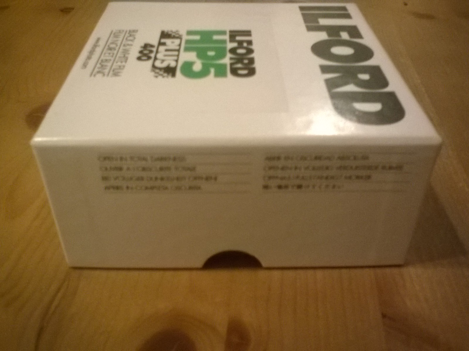

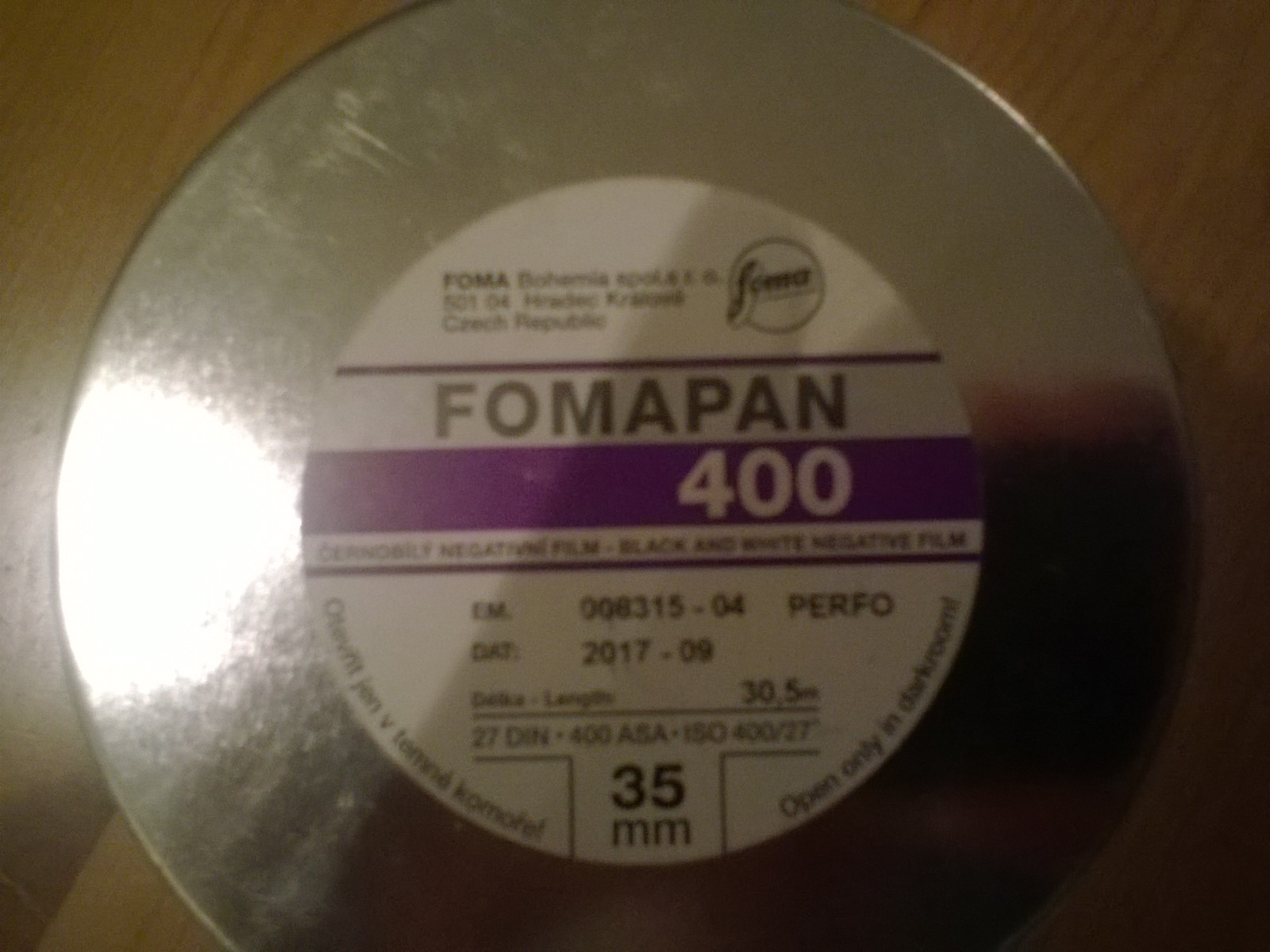

As you are confused, better is to show you a box of Ilford HP5+ and a can of Fomapan 400.
As I said above, the Kentmere 400 I had didn't came with the warning on the side as Ilford comes.
Here the Ilford box on its side:

For comparison the Fomapan can:
Here are the cores used: 1" on the Ilford and 2" core on the Fomapan.
You can see they fit neatly together.
I hope that it is clear now.

Thanks Ricardo. I cannot read what is on the side of the Ilford HP5+ box but I take it that it does warn you to only open in complete darkness. It also appears that there is no tape sealing the black bag. Is this correct?
Neither is there any such warning of only open in total darkness on the Kentmere bulk film box , which is a pity.
Maybe a folded-over blackbag has been tested by Ilford and it is satisfied that the folding makes it light-tight.
pentaxuser
Yes, it says "Open in total darkness".
No tape sealing the bag, but there is tape at the end of the roll.
