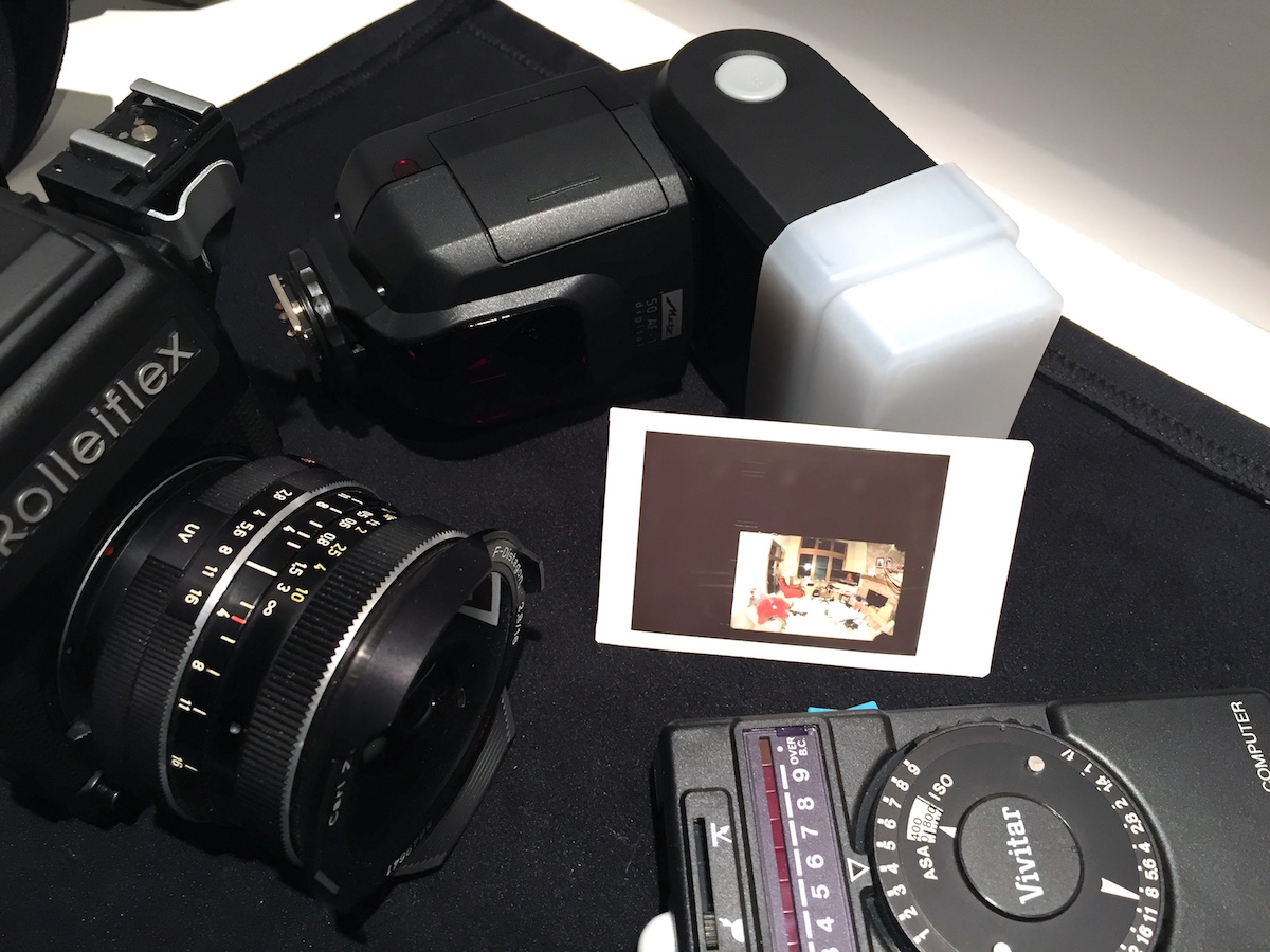

A key element to interchangeable backs is the darkslide. For example the Polaroid back for the Rolleiflex cameras has a darkslide, so it can be loaded with Instant Fuji film to make an exposure during the middle of a 35mm roll by swapping backs.
instax-rolllei-35mm-small-jpg.248988
img_0984-copy-jpg.255990
