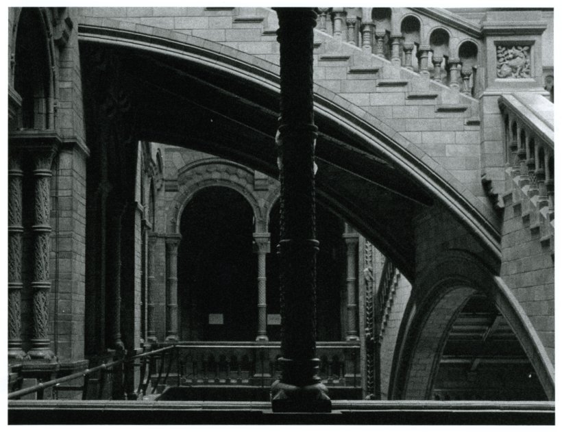

I've done delta 3200 (at EI3200) 35mm in Rodinal before. It somewhat depends on the situation as to how much grain shows up, in my experience.
