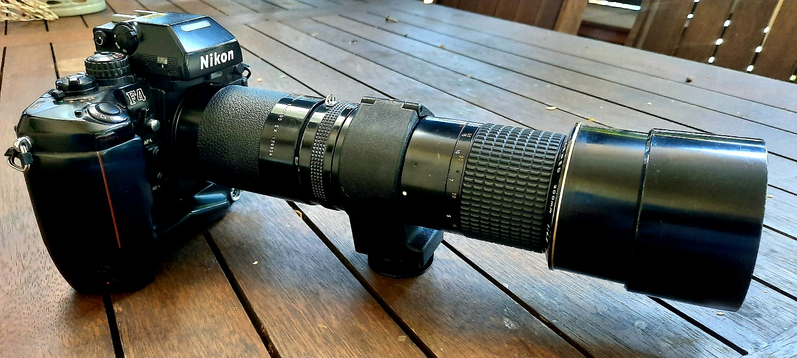

I've had the Nikkor 300/4.5 ED (AI) manual focus lens, and it was excellent. Has a rotating tripod mount, which is handy. I actually did a lot of sports photography with that lens.
If I was looking for another one, I'd consider the 300/4.5 IF ED (AI or AIS), which are a bit smaller and lighter, but also excellent.
