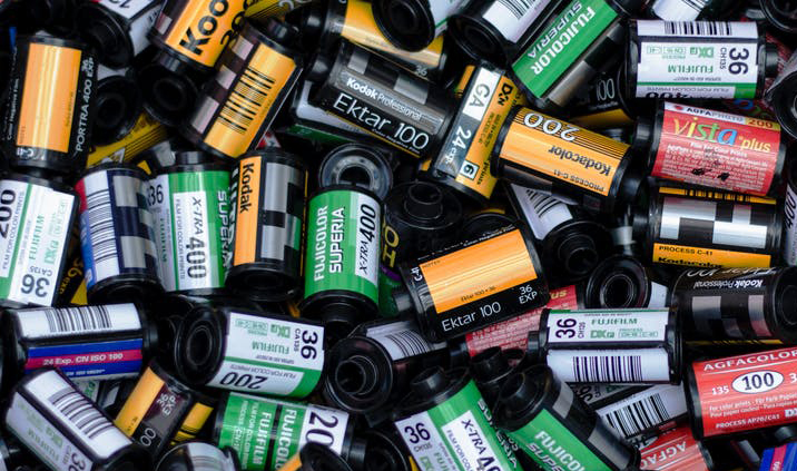

You need to be motivated. I've got a rack for a 3 1/2 gallon tank, 30 Hewes reels, easy to load even wet. Personally I would not waste my time. I'm assuming that the picture is NOT the film in question?
