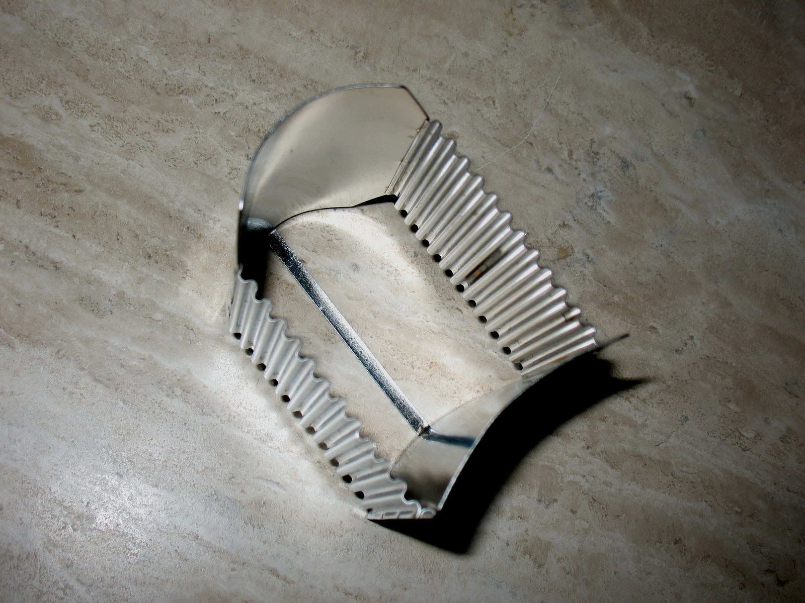

Nikor made this holder a while back. It requires a tank slightly taller than many 120 stainless steel tanks.

The Nikor was excellent. Still have a Combi...it's far more fussy than one Nikor but it also handles 4x5.

I usually use the Nikor sheet film tank, which is a round tank adjustable for all sizes (most now obsolete) from 2x3” to 4x5”, but I also have sheet film hangers and can have done it in open trays. They all work. Open trays are best for low volume. The Nikor tank does 12 sheets at a time. If you’re cranking them out, go for tanks and hangers.
The plastic reel you show works like the Nikor tank, but the Nikor holds 12 sheets, and the tank is larger in diameter.
