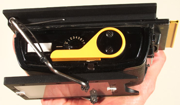

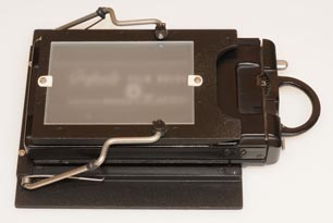

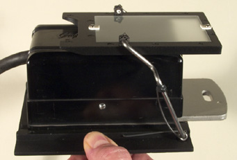

Horseman had a 6x9cm reducing back for their 4x5 cameras. This was a separate item from the 4x5 to 6x9 rollfilm back adapter.
It is a ground glass back that takes a 6x9(2x3) film holder with the groove on the top and bottom. The sliding metal keepers fit in the groove to keep the film holder tight against the back. It also accepts the standard 6x9 rollfilm back from the 6x9 cameras.
Nokton48
Oct 8, 2006
3,113
www.glennview.com
I bought one of these and converted it to Plaubel Peco Junior. Could fit 4x5 too. It's at the bottom of "View Camera Accessories".
6X9 Galvin Graflock back on steroids, will accept Graphic and Horseman rollfilm holders meant for a 6x9 back w/o the need to remove the GG back, with GG, outside dimensions 5X5", illustrated with 23RH10 rollback (not included), the spring does not obstruct the rollholders advance lever, new, $80. Will accept a 6X9 Grafmatic (not included). Will even accept a very thick 6X9 Graflarger back (not included)!
