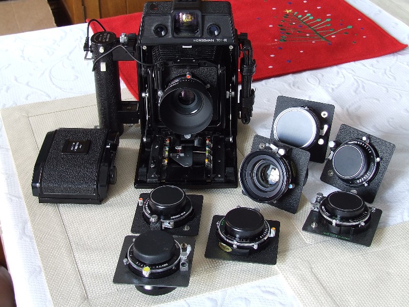

Personally, I have only used the Horseman/Topcor lenses. I have all of them and they are excellent performers.
No f2.8 lenses, but there is a 'normal' f3.5 105mm that will foldup inside the camera.
