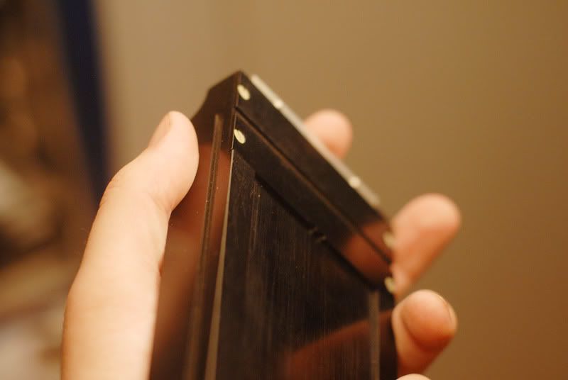

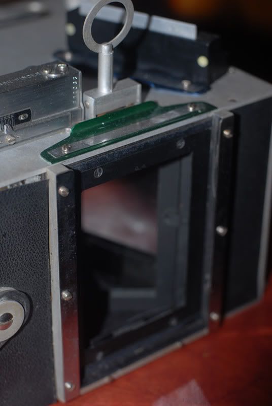

Sorry for the delay in my response. So my options are to either find some old Graflex holders or find some Graphmatic holders. What I would really like to do is use a 120 roll back though. My main concern is that one of the slots doesn't have unlimited space. These pictures should explain it better.
This is the room I have to fit a roll back. I guess I could make the hole bigger though. It's about 7/8th of an inch by a little more than 3 inches.
This is what the back looks like:
Here are the holders I have, they are for film packs though so I obviously can't use them. Notice the grooves:

There's no way that a Graflex-made roll holder will fit in the slot that accepts the "blue" film. None. Give up on the things, they won't do for you. And they all, except the much deeper RH-70, have the same depth, there's no rare variant that will save you.
FWIW, I just measured an Adapt-A-Roll 620. The insertion end is 17.3 mm front-to-back. As I've told you, an AAR 620 won't attach to a Graflex (that's Graflex as in Graflex SLR and yes I have one) back. It can, however, be used with a standard spring ("Graphic") back as on the newer Curtis you showed. You may be able to attach spring backs to your Curtis. But and however I have no idea whether an AAR 620 will fit in your camera's "blue" slot or what would hold it snugly against the gate.
Why don't you just get three 2x3 Grafmatics for Graflex backs and do as Henri Gaud does? I think he's farther along than you.
Alternatively, and this will be a real pain, you can put a single sheet of film in a pack adapter. To take more than one shot in a session you'll have to have a pile of pack adapters or reload using, e.g., a changing bag.
