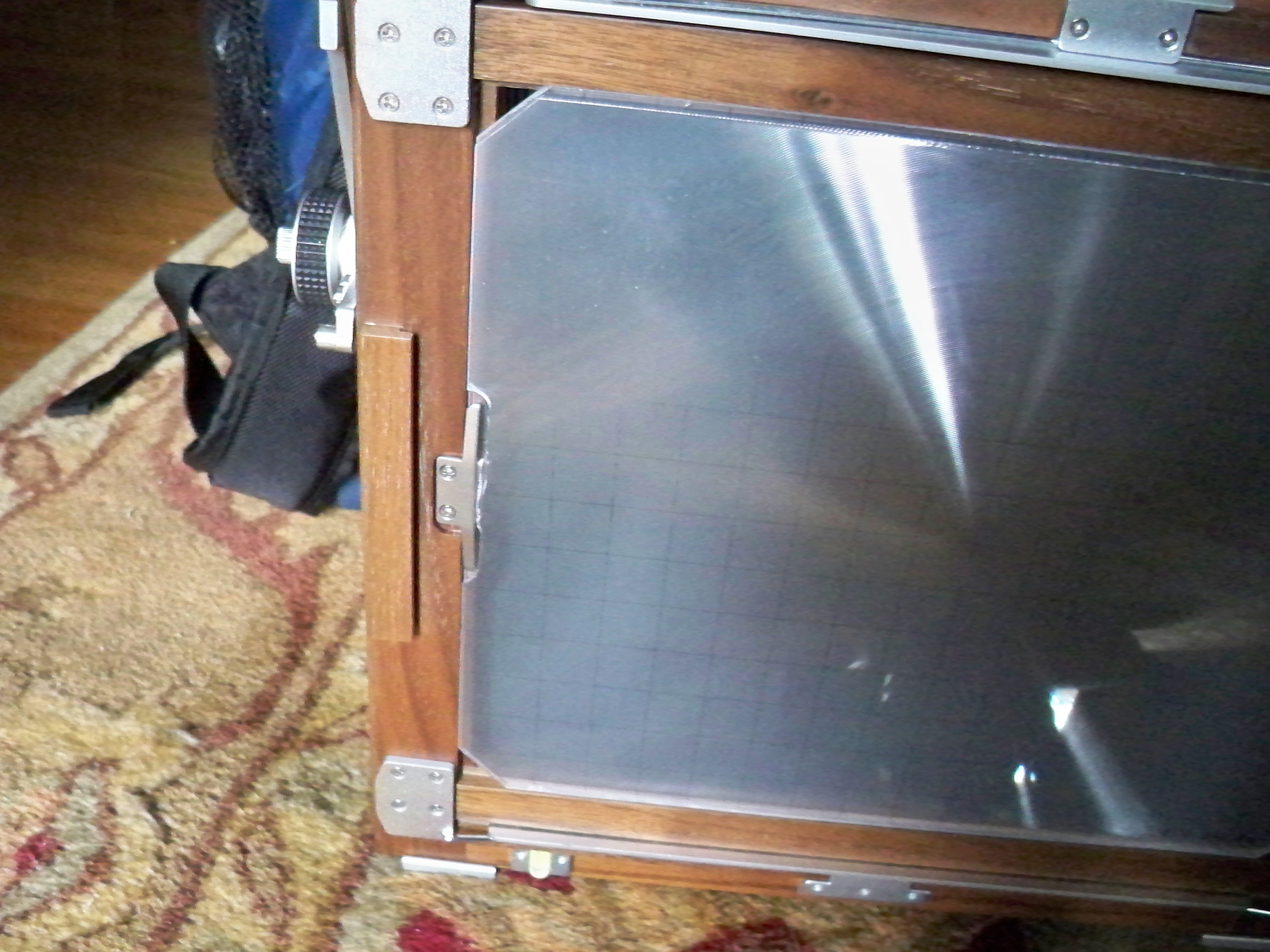

I, non-destructively, placed a larger and thicker one on the back of my view camera in 2012 to see if it made any difference. It is still on there, I think it helps composing. . It also serves as a ground glass protector,
I tried one of those 8x10 fresnel for book reading, and find the pattern a bit distracting. It does even out the brightness. So it is a tradeoff.
In the end, I still prefer plain good ground glass with dark cloth and loupe.
