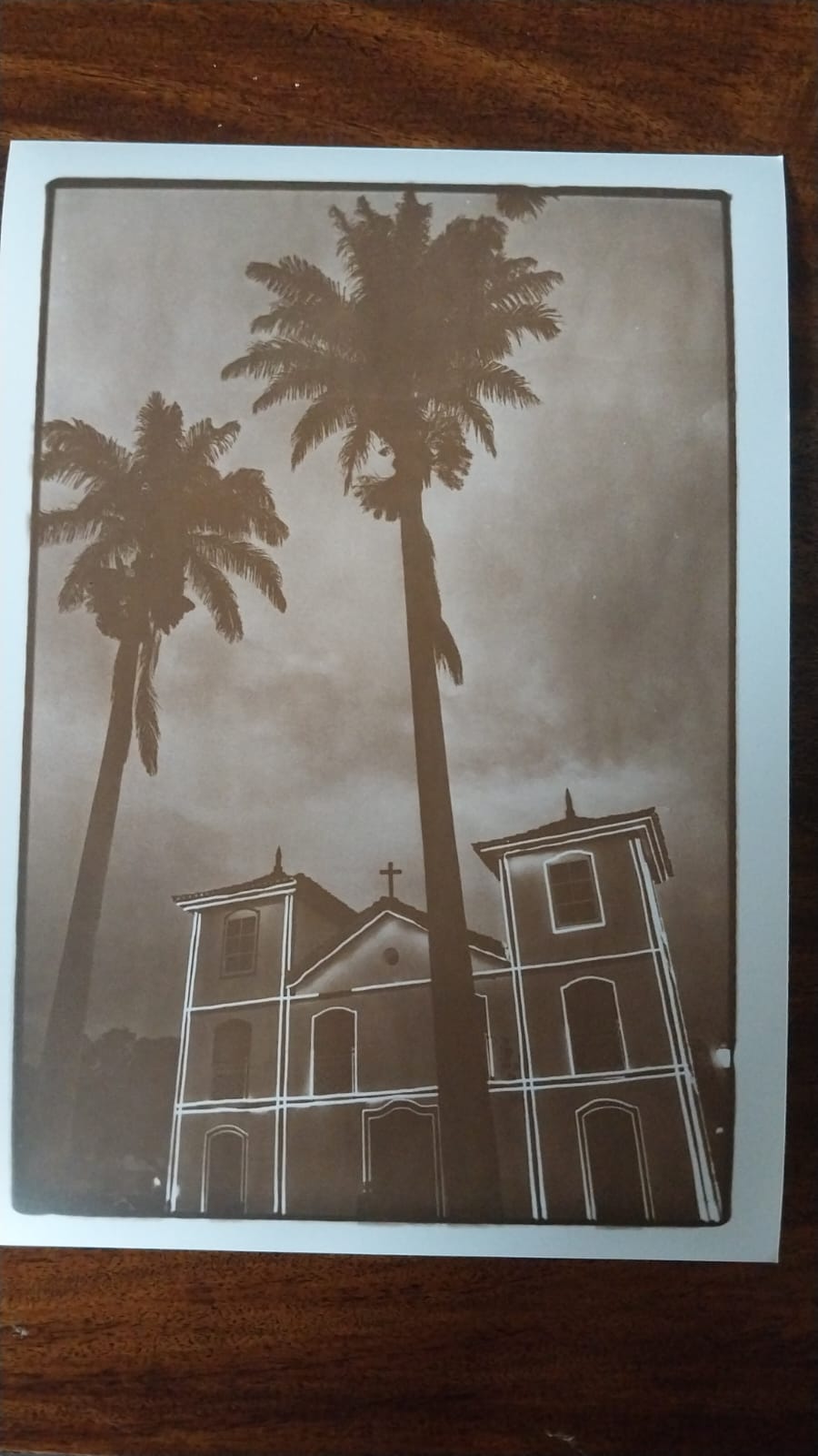

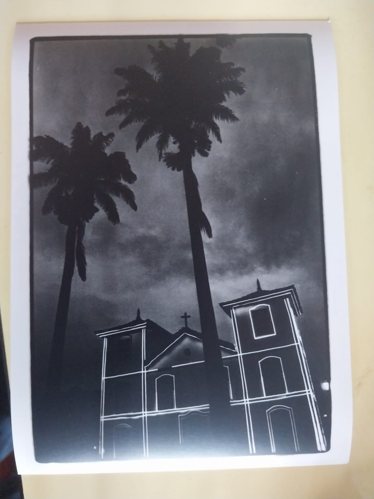

Yesterday evening I tried unsuccessfully to do 2nd pass lith printing. I had two prints at the ready: 1) a print deliberately overexposed by half a stop on Ilford MG FB Classic paper and which had been developed with home made Agfa 135 developer with extra potassium bromide for warmth. 2) A print on Ilford MG RC Classic pearl finish paper that had been overexposed accidentally some years ago. It would have been developed in Ilford MG developer.
As was discussed in my recent thread starting here: https://www.photrio.com/forum/threads/2nd-pass-lith-question-about-developer-dilution.210207/ , I used Wolfgang Moersch's instructions and started the process by bleaching the above prints. Here's where things started to go wrong....
Step 1 - Bleaching
I used the following formula and had read somewhere that the copper sulphate bleach should be used at a dilution of 1+9:
Copper (Cupric) Sulfate..................................50 g
Concentrated Sulfuric Acid (EXTREME CARE!)..............6.5 ml (232ml of 2.8% solution) *
Sodium Chloride (Common Salt)........................... 50 g
Water to make..........................................1000 ml
I don't think I made any mistakes with this. I purchased the most dilute sulphuric acid solution that I could find (2.8%) and calculated that I would need 232ml to match 6.5ml of concentrate.
The subsequent 1+9 dilution of the above took forever to bleach the prints and I had no patience or time to bleach either fully, as suggested in Moersch's PDF. For the FB print I kept adding more copper sulphate bleach until I had ultimately a 5+9 dilution. I bleached for a full hour but all the same, a pale image was still visibly well present on the print when I gave up.
One interesting thing happened though, while the FB print simply got more pale in the bleach, the RC print turned a very nice dark brown hue. Unfortunately I didn't take a photo of it at that point (and later destroyed the print in subsequent steps), but would this print have been stable after washing?
Step 2 - Redevelopment
I used home made Ansco 70 as my lith developer. For direct lith printing, a 1:23 dilution is recommended as a starting point. I chose to dilute this by a factor of 10 for a 1:230 dilution, adding 2.2ml each of parts A and B to a litre of water at 40°C.
Because my FB print was the more pale, I chose to use this first. I added it to the developer solution. Redevelopment took place however it was very slow, I think it took 15 minutes, although I don't remember. No, I didn'rt have a baymarie to keep the solution at 40°C. There wasn't that much of a colour change at this point (probably not helped by the slow redevelopment). The print was perhaps a little warmer, however.
Step 3 - Stop bath and fixer
The stop bath showed not change as expected. Moesrsch's document does warn that the print will brighten some in the fixer and that the print should be "snatched" form the redevelopment solution (in my case, no such urgency was necessary) with the print a darker shade than that desired in the final product. When however I placed my print in the fixer, the print immediately turned a sickly pale orange, far too pale to be displayed and probably 2-3 stops lighter than before it went in. I then went on to destroy my nicely toned RC print.
What might have gone wrong here?
Thanks!

Perhaps it was one stop. It was quite dark. I have a photo of the RC print before it was processed, but not the FB, unfortunately. The FB print was at least as dark:

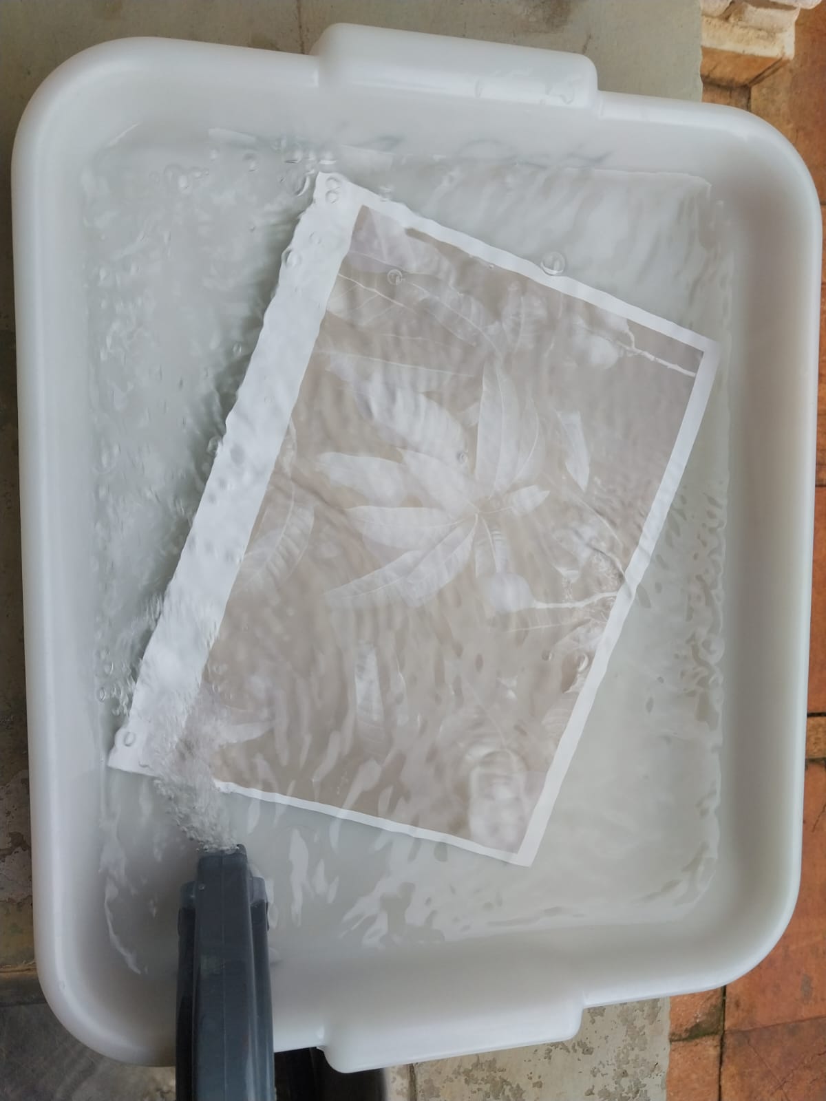

I have a photo of the FB print at the end of 1 hour of bleaching in the wash tray:

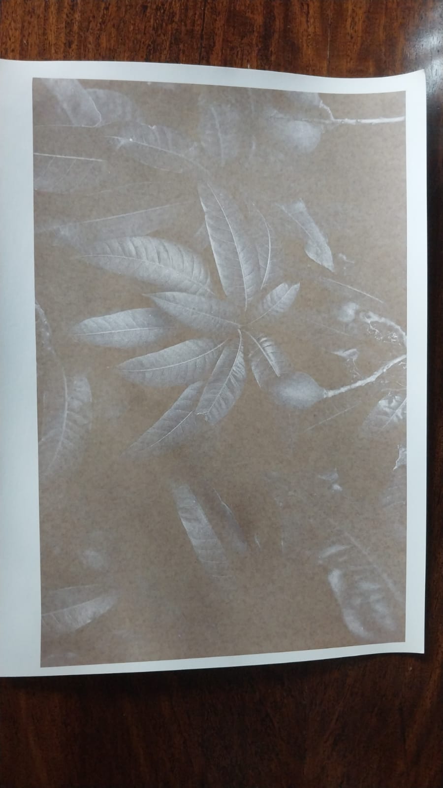

Oh and here are my two prints after fixing. In the case of the smaller RC print (church), I hardly did any redevelopment because the print was already with a nice darkish brown shade. Interesting that the fixer took away what was there before redevelopment (of which nothing noticible was added.

I should add that I noticed that the redevelopment of the FB print in the 1:230 Ansco70 developer, was very gradual - after 15 minutes or so, I gave up and put the print in the stop. Moersch advises to keep the print in the stop for longer than normal. I usually put prints in the stop bath for 30 seconds. This time I did 45 seconds before transferring to the fixer.
Thanks; this helps. This is an incompletely bleached print.
I'd expect this to happen if the fixer, the tray or the print somehow became contaminated with bleach just prior to, or during fixing. This would turn the fixer into a reducer bath.
Time in the stop bath shouldn't be very critical; 30-45 seconds sounds fine. I mostly did single pass lith and usually stopped for maybe 10 seconds or so.
