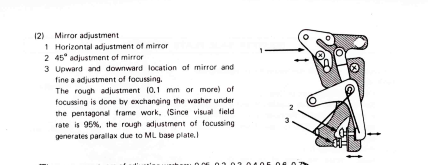

Screw #3 moves the mirror upward and rearward (away from the lens) when it is loosened. This is to adjust focus along with screw #2 which affects the 45 degree position of the mirror. Perhaps these are messed up, causing the mirror to be too far forward. You can push on the mirror and see how screw #3 is keeping it from coming forward too far.

It appears mirror is now damaged unfortunately from hitting the back of the lens. I looked for a screw that stops the mirror's forward motion and didn't see anything, but I'm not very familiar with these cameras. I just bought the camera and am going to ask for a refund, which is sad because it's in mint condition otherwise but the mirror appears to have been damaged now, too, so not sure it's worth repairing.
