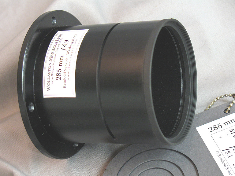

285mm f:4.6 Wollaston Meniscus lens
A simple meniscus lens, mounted in a PVC barrel configured to replicate the first true photographic lens invented by William Wollaston in 1812. Use it wide open for a very soft and "dreamy" photo. Progressively smaller apertures sharpen the image and creates a "turn of the century" photographic look. The bridge was shot at f:5.6 & f:11 on a 5x7 Deardorff.
The lens is a quality glass optic in a machined PVC barrel and flange. A 72mm metal filter ring is bonded into the barrel. Five aperture cards (aka: "Waterhouse Stops") from f:5.6 to f:22 are included.
I have 135mm, 155mm, 190mm, 250mm, 267mm, & 285mm lenses at the same price. Data sheets for each lens are here:
http://re-inventedphotoequip.com/Site/Data.html
Unmounted lens (includes the flange & screws): $65 + $11 USPS shipping.
Flange mounted on a Technika style lensboard (details on my website): $89 + $11 USPS shipping
Custom mounted on your own lensboard: Ask for a quote
A previous thread on the 285mm lens is here: (there was a url link here which no longer exists)
More about Wollaston lenses here:
http://en.wikipedia.org/wiki/Camera_lens#The_earliest_photographic_camera_lenses
Reinhold

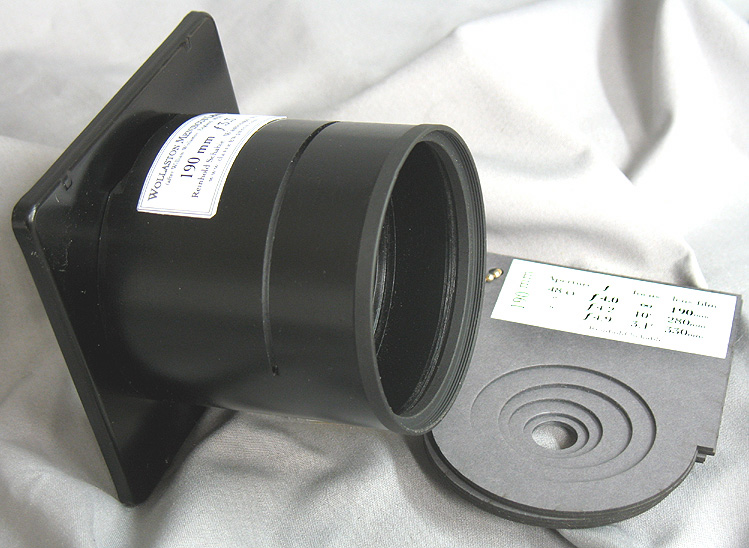

It just so happens that I have an extra 190mm on a Speed Graphic lensboard.
It has an edge chip that is just noticable at wide open aperture.
The completed, mounted lens on the SG board is $158.
The chipped edge qualifies you for a $10 discount.
So... $148 + $11 USPS shipping.
Reinhold
www.Re-inventedPhotoEquip.com

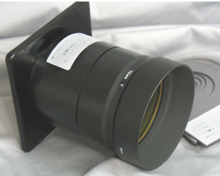

I forgot to attach a photo of the lens.
Here it is, one photo shows the 190mm lens with it's 72mm filter ring on the Speed Graphic board. ($148 + shipping).
The other photo illustrates the lens with a filter and lenshood (not included) just to illustrate how this baby would look on your Speed Graphic camera.
Reinhold
