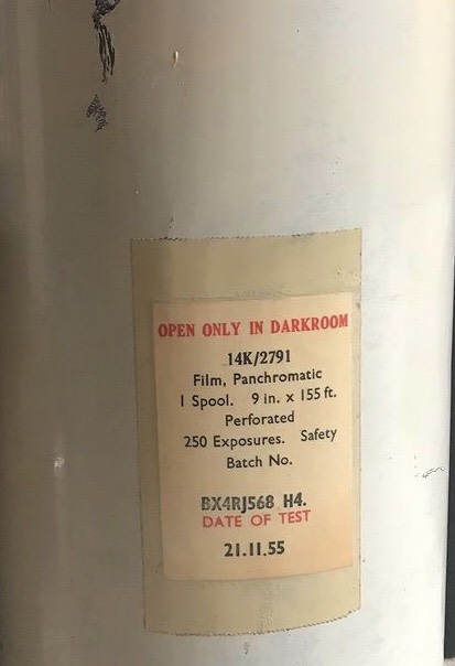

A friend of mine has bought a cannister of what is assumed to be Aerographic film, but neither of us can find any information on it!.

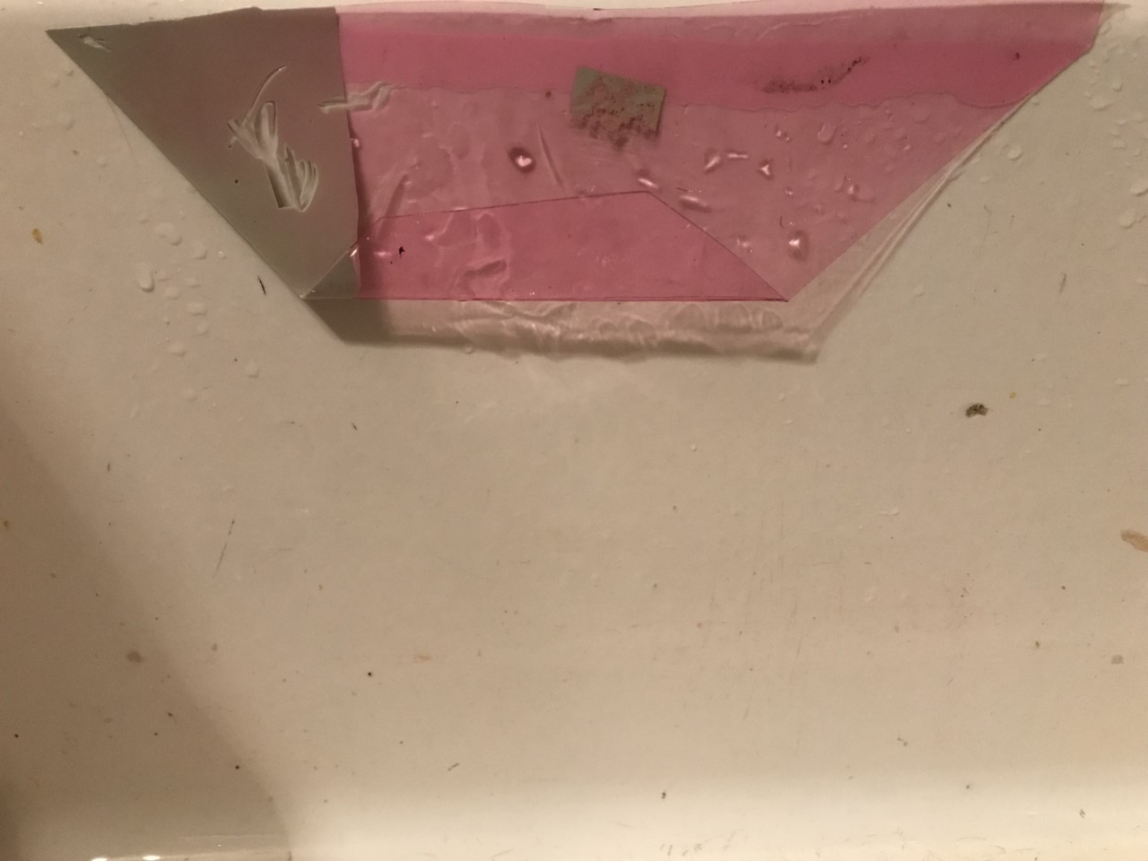

With a test of fixing the film only, it has a pink film base.

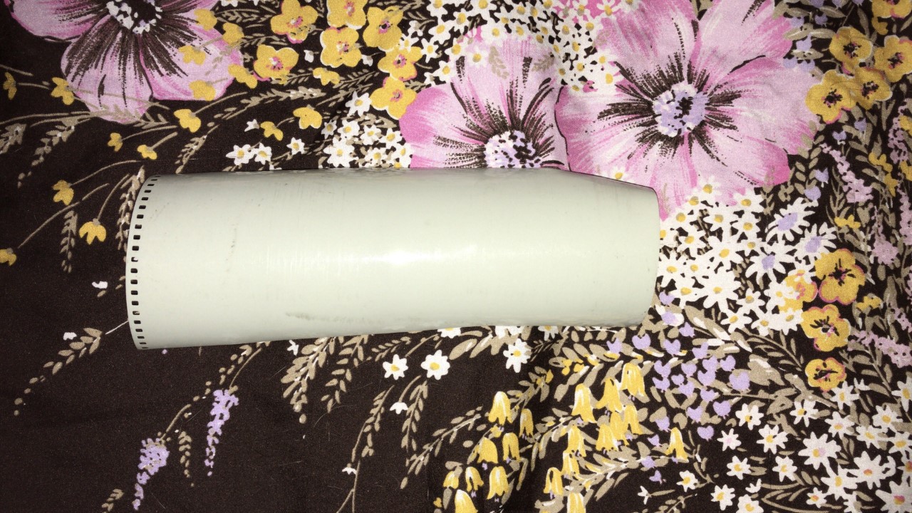

Perforations are along one edge only!.

Nice! Next question, how much fog has it racked up? That 155 feet is more than two hundred 8x10 sheets -- about two thousand bucks worth of expired fun.

@Mogsby I think it's highly likely to be a Kodak product; they pretty well own the USG contracts back in the day. For age, it might be anything from 1950s to 1980s vintage, I don't see any reliable way to tell. I'd suggest developing an offcut to check fog.
Start with a drop test: cut a snip, and in the light, put a drop of developer on the emulsion. Time how long it takes to turn full black, and develop with normal agitation for five times that long as a starting point. Cut another snip (or a 61mm strip off the end, so you can load it into a reel), develop for that starting point time without exposure and compare the result to your fixed-out snip. That'll give an idea of fog.
Once you know how bad the fog is, you can make a guess at speed -- cut another 61mm strip and load it up in a 120 roll, and shoot a bracket. I'd start with EI 25 and work up in one stop increments; you should be able to get 25, 50, 100, and maybe 200 on one strip. What you get for results will tell you if you need another strip.
The beauty of this compared to the usual "I got some oddball film of unknown age" is that you have a bunch of it, not just a single roll or even two or three rolls. You've got five hundred feet. You can afford to spend some in testing.
