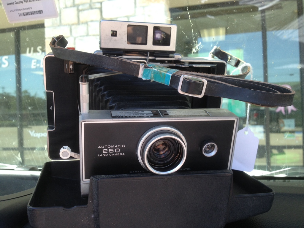

Stopped at a country antique store today while out riding in the Jeep, and he had two. This one was priced at $150 "because that's what they are online."
Offered him $50 and he bit.

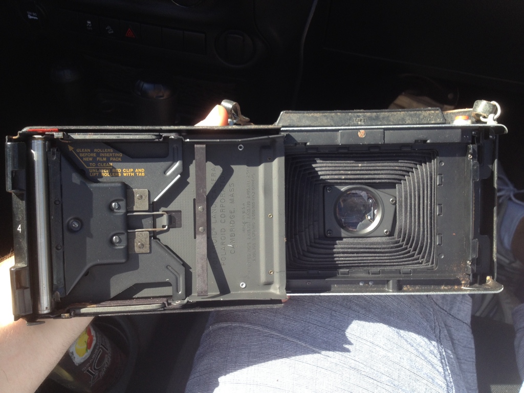

Really clean, and the strap isn't even undone. I think it will work... At least I hope so. There's $50 riding on that "magic eye"!
If you ever have trouble with the shutter...(there was a url link here which no longer exists)

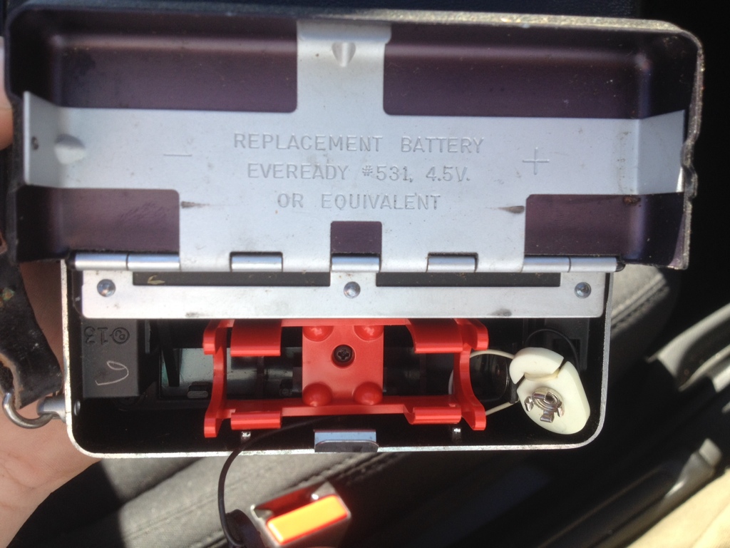

My $50 gamble paid off! I used the battery insert from a $5 LED flashlight with three AAA batts, and it works!
Shutter works well, magic eye seems accurate, and the switches move easily.

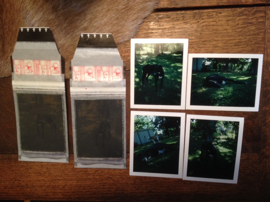

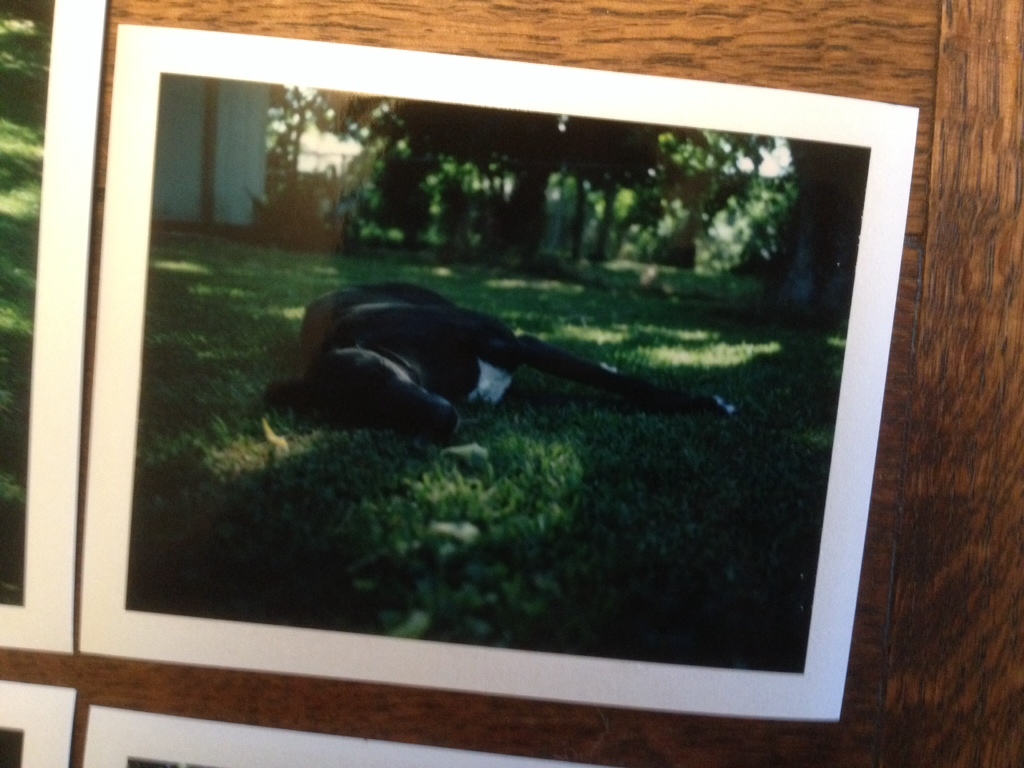

So my gamble really did pay off. It works perfectly. Now I just have to figure out how to nail the exposures.
Is it me, or are all the 250's in the dark side if the exposure scale?? This is my second one and it's just like the first! DARK!
All those shots are backlit and in the shade.
Try one with even, front lighting:D

It's set on 75, and u have it turned 1/4 towards lighten. It's set on outdoors without flash too. And I squeezed the button. I always pause a second or two to make sure the shutter closed.
My last 250 was the same way though, or maybe I just haven't mastered the exposure thing with this model.

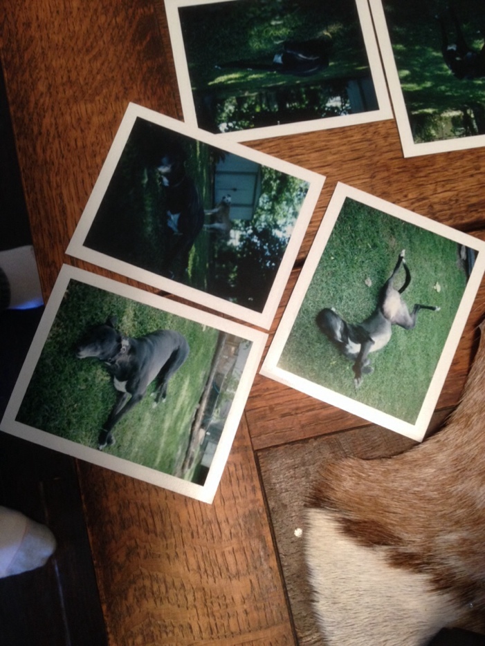

So I got home today and decided to just crank it all the way to lighten. Same time of day. Same shaded area of the yard, although the sun was to my back. But there was bright spots on the house.
Much better with it all the way cranked to lighten.
Could be that the photocell is pretty faded. I would say rate it at 50, which should give you some latitude on the lighten/darken dial.
I had a 250 with a very faded photocell. I taped a piece of paper napkin over the light sensor and it worked pretty well.
