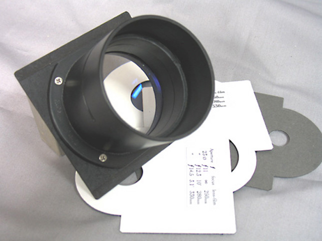

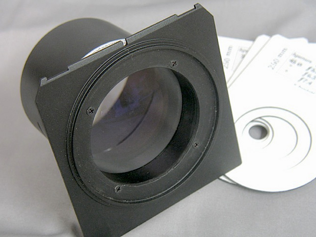

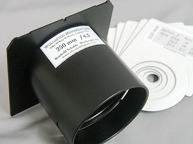

This is a simple meniscus lens mounted in a PVC barrel configured to replicate the first true photographic lens invented by William Wollaston in 1812.
The image circle is 13" at f:16, so it's ok for film up to 5x7, even with some movements. Using it wide open results in a very soft and "dreamy" photo. Progressively smaller apertures sharpen the image and creates a "turn of the century" photographic look.

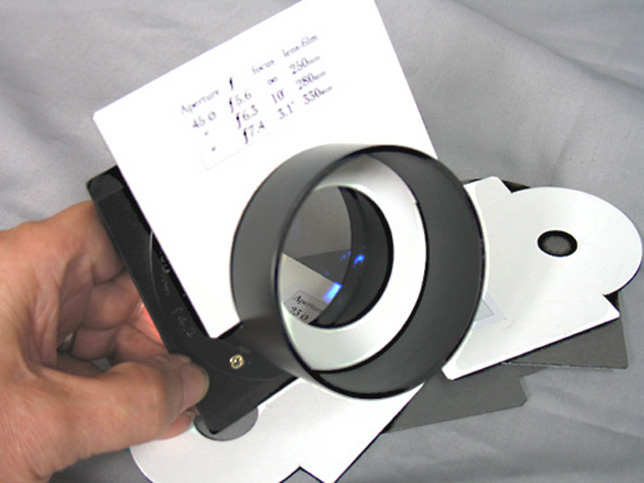

Five aperture cards (aka: "Waterhouse Stops") from f:5.6 to f:22 are included. They are die-cut from matboard and have a simple chart listing effective apertures at 10' and 3' focusing distances.
The lens itself is a quality glass optic in a 2-3/4" long x 2-7/8" diameter machined PVC barrel which serves as a very effective lens hood. The card slot abuts an internal light trap to minimize light spill around the edges of the card during exposure.
It's flange mounted on a simple 96x99mm lensboard which fits Tachihara, Shen-Hao, or any other camera that uses the common Technica board. If you have a different board, the lens/flange assembly is available unmounted (screws are included). I can also custom mount the lens directly to your board without using the flange. Ask for a quote.
Focusing a wide open meniscus lens is challenging, especially in low contrast lighting. A "Hints & Tips" sheet on using this lens is included. The photo's are 5x7's at f:5.6 & f: 16.
Unmounted (includes the flange & screws): $55 + shipping.
Flange mounted on the lensboard (as in the photo) : $69 + shipping
Custom mounted on your own lensboard: Ask for a quote
190mm, 250mm, 285mm, and 310mm lenses are also available at the same price.

Wollaston Meniscus on Linhof/Technica board
Here's a photo of my 250mm Wollaston Meniscus Lens custom mounted on an after-market 96x99mm Linhof/Technica lensboard that the customer supplied
I bored the hole to 60mm (2-3/8") diameter and mounted the lens with four #3-48 flat head Phillips machine screws threaded directly into the lens barrel. This made a clean compact installation without the need for a flange. My charge was $39 for this job.

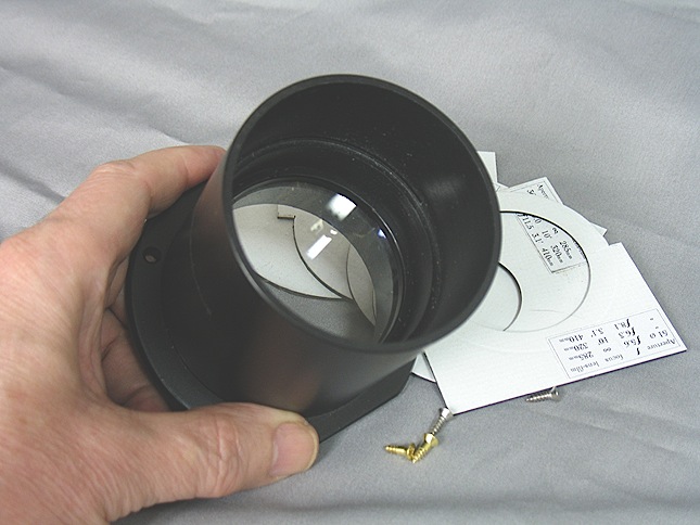

Can you relate additional specifications on the other focal lengths? Are they all f/4.3 or are they in the same size barrels as the 250mm? Image circles? I'm particularly interested in the 310mm.
I'm currently making two 310mm lenses, so here are some spec's:
The clear aperture will be 58~59mm.
Focal length, (310mm) divided by the aperture (59mm) equals f:5.2, wide open.
The image circle is at least 400mm, but I haven't had a chance to do an exact determination. (Remember, primitive, single element lenses have somewhat nebulous field of view edges, so don't expect uniform light and sharpness out to the very edge...).
The 285mm lens has an image circle of about 355mm, and a maximun aperture of f:4.9.
I have one completed, ready for sale.
The 190's image circle is not yet settled, there's lots of wiggle room for 5x7.
The 190's maximum aperture is f:3.3 . I have a 190 ready for sale too.
External dimensions are the same as all the others:
The barrel is 2-7/8" diameter x 2-3/4" long.
The PVC flange is 3-5/8" diameter, 3-3/8" across the flats, with four countersunk screw holes for #4 flat head mounting screws.
