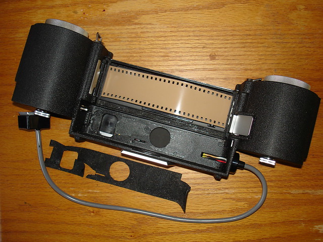

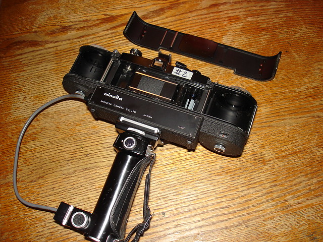

I bought this Minolta SR-M 250 exposure back from a nice fellow from Ireland. It was new in the original box and never used, his father was a Newspaper Photographer in Belfast, and won the back as a top prize in a photo contest. I have loaded it with Eastman XX 35mm movie film, and it works perfectly, but it is gummy inside and needs a cleaning. It did stop running a couple of times, I rapped it gently on a wooden table, and it started up again chugging right along. I need to find a good tech familiar with this unit and get a CLA and new light seals. It's pretty cool and I'm glad I found it. I found a bunch of original SRM 250 cassettes and a bulk loader so all set in that regard.

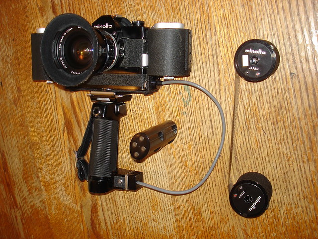

The Minolta XK MOT with the 250 Back is also fun. I bought such a back for $300 and then returned it 'cause I don't have an XK MOT. It was a beautiful piece. My SR-M 250 Back has a film cutter built in, you can shoot whatever length you want, then go in the darkroom and cut, and develop the however long shorter strip. Nikon might have this option??
Come to think of it, I have a number of 72 exposure JOBO 35mm reels and a JOBO loader. So three of those reels could handle 250 exposures and go into a 2500 series JOBO Multitank. Hmmmm....... :smile:
