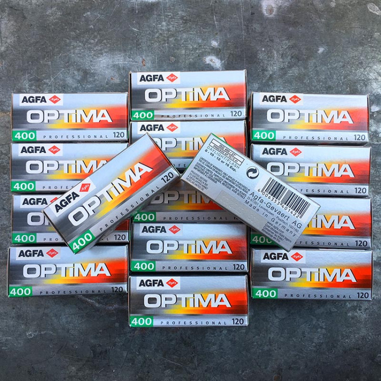

2) ......I remember that I also have Optima 100 ft rolls, it just occurs to me that there should be 2 or even 3 rolls.
Optima II 100. That is now worth a fortune!
3) most Optima I stored are 120 Agfa Portrait 160
