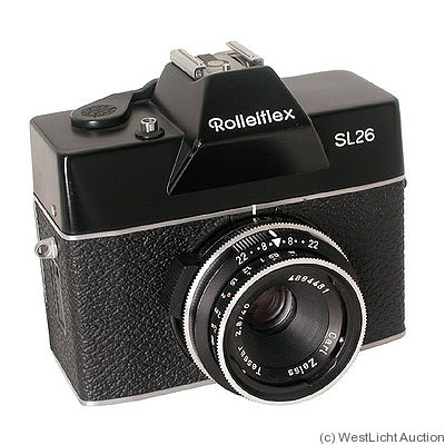

The 126 format film was 35mm wide with about a 26x26 square image.
