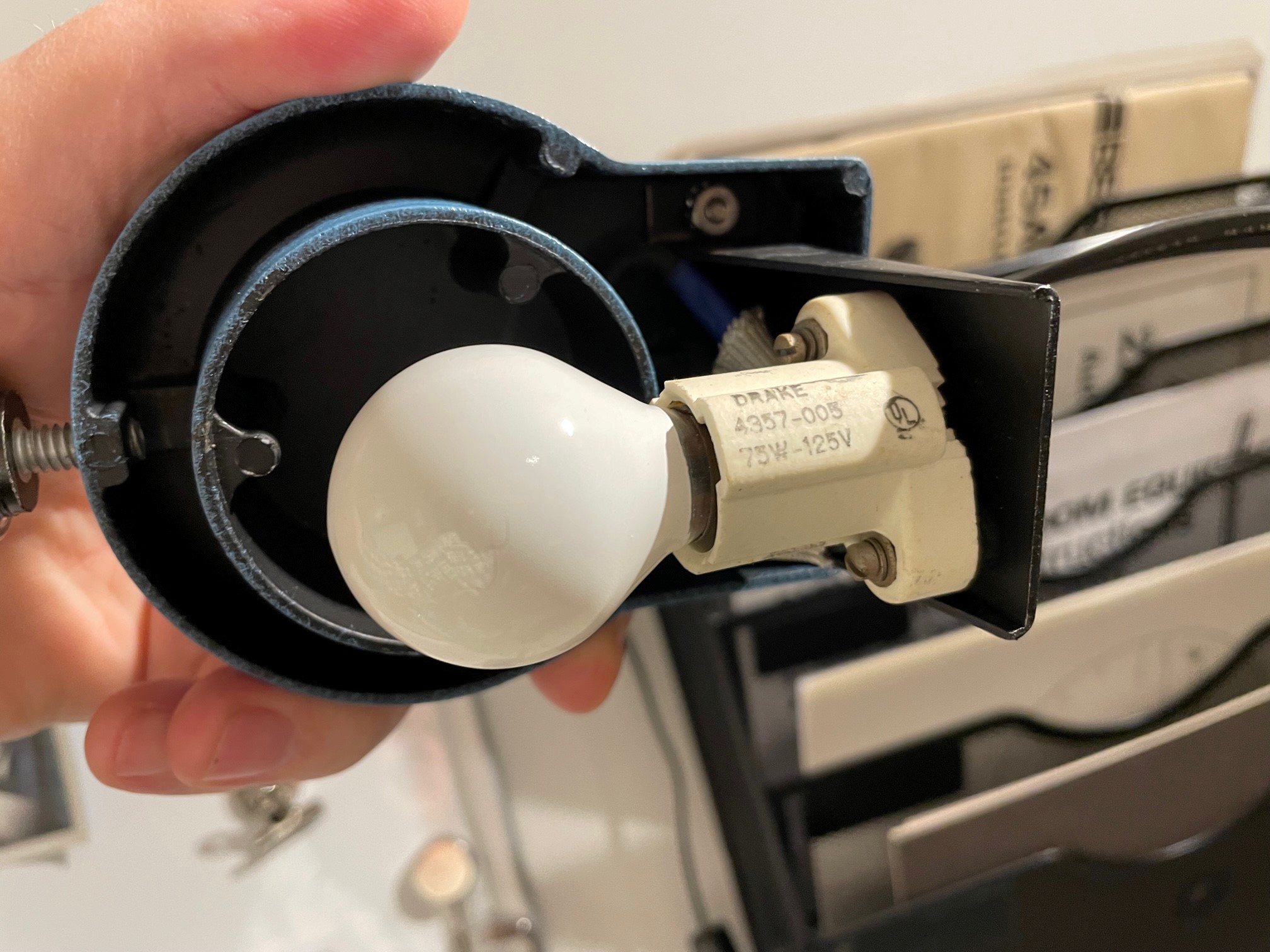

2. FIgured out the bulb i need to get,,, its the uniquelyfun PH-111 or PH-111A. It even matches what is in the lamphouse socket
Now as said elsewhere in the incandescent ban thread, my bulb is either jammed or corroded into the socket. I have emailed KHB for assistance, but havent gotten a stinking reply in 3 days. Not right in my opinion.
It pushed into the socket slightly, perhaps 1mm but wont turn, and it sounds like sand is in it. As its mounted horizontally and is very close to the metal plate, what is the bestest and safest way to get it out?

The bulb on mine is a bayonet mount; did you push in and turn? A bit of wiggling may be required if the socket has become crusty...

it took some wiggling, and i wasnt pushing it in hard enough... or turning it to the side enough..
tiny little knobs suck.. at least i can do it now.
