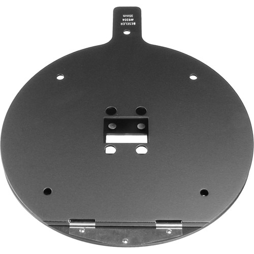

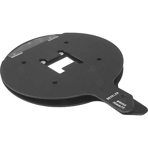

I’m needing to acquire a 6x7 negative carrier for the 45MX. There seems to be some confusion amongst sellers and sometimes the paddle looking carriers are listed as 23C carriers instead of the 45.
Are those round paddle looking carriers for the 45 and the 23C the same size? Are they interchangeable? Or is the 23C smaller in circumference?

The 6x7 negative carrier for a Beseler 45-series enlarger is part number 8328. They seem pretty hard to come by. I just use the 6x9 carrier and mask off the extra width.
The carriers for the 23c are noticably smaller in circumference. The attached images are both glassless 35mm carriers for the 23c and 45, respectively.
The 23c carriers are far too small to be used in the 45 series enlargers, and I would assume they are incompatible the other way around as well. Beseler_8055_35mm_Full_Format_Negative_1536010919000_4653.jpg
