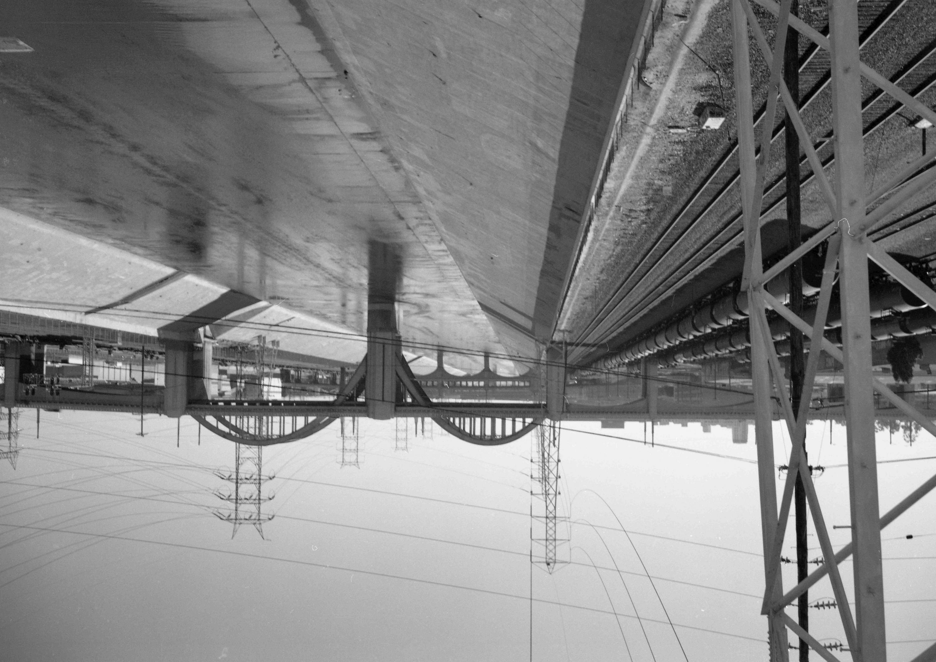

How are the pictures? Here's one, from my test roll (expired 220 Kodak T400cn c-41 b/w film). Excuse the probable upside down and backwards image; that's what Preview does for me every time I copy an image, and no amount of correction can stop it. If it is miraculously upright and forwards, then forget i said anything.
