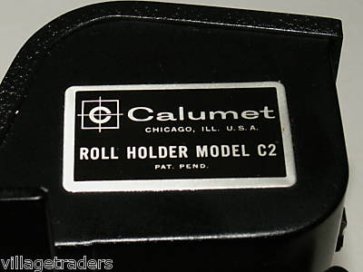

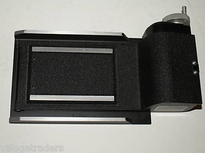

If I remember correctly special equipment early start line is for film backs like the calumet C2 roll back that fits on 4x5 view cameras. I got one when I bought my first 4x5 Crown Graphic. It was nice because I could slide it under the ground glass like a film holder. It has a really wierd film loading path. See attached pictures.
Jamie
