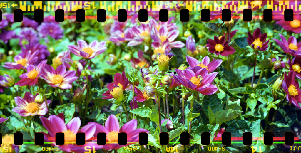

I'm in need of some information for doing panos with 35mm film in my Bronica 6x7, namely the distance between the "start" mark on the paper and where the film begins. If anyone has recently developed a roll of 220 and you still have the leader paper, could you provide the length between these two points?

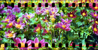

I have the take-up spool taped to keep the 35mm film straight. When it's at the end of the roll, I take the back off in the DR or changing bag and roll the film back into the cartridge. I get 12 exposures on a 24 exposure roll, but there's enough room for another exposure, thus the need for knowing the distance between the start mark and the film.

Length of paper = 22.25"
Film to Start mark = 7.5"
There's about an inch and a half of unexposed film past the paper, so I'm going to try 8.5" for my start mark to film.
