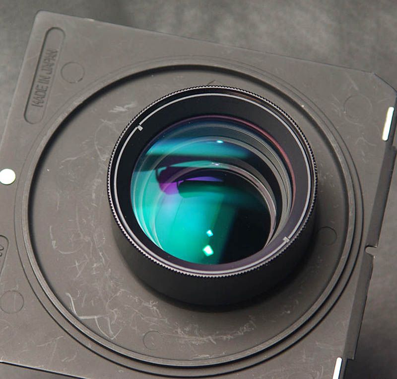

I'm wondering which lens would be the best to go with on my 4x5 Graflex camera? What I see on Ebay are some Schneider-Kreuznach Symmar 210mm f/5.6, a Rodenstock Sironar 210mm f/5.6, and a Fujinon 210mm f/5.6. Many have the Copal shutter. I'm looking for a lens that is good for both portraits and also landscape crops for closer view shot like tulips closer up, etc. I want a sharp lens and with good contrast in the $200 range. Must fully cover 4x5 film. Any suggestions? Many are in the same price range, so its hard to choose.
Also is there such a thing as an inexpensive 600mm lens for 4x5?

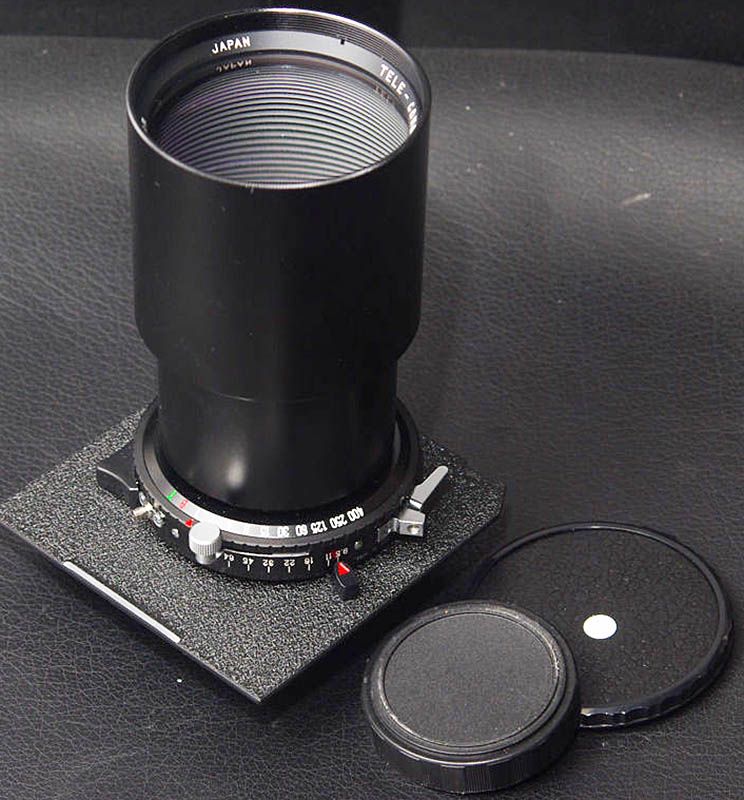

Also would a Yamasaki tele Congo 500mm f/9.5 lens work on my Graflex?

If it is a true tele it should, if not need an lens board that is build out to give more reach to the bellows.

I don't know if it a true tele or not. It extends quite a bit forward from the lens board on the front, as it is a rather long lens. Would that qualify?

Seems that lens although a tele design is designed for MF and does not cover a 4X5 well, if your Speed has a interchangle back you could use it with a 6X9 back.

I found a 400mm Congo from the same manufacturer on Ebay for a little more money. It claims to have coverage for 5x7, so that lens should be okay. I BIN'd it. So now I have 2 lenses coming for my 4x5 camera.

If you have a 4x5 Speed Graphic, you lucked out. A 400 Tele Congo will focus to infinity on one and will allow room for movements. A 500 Tele Congo will also focus to infinity but will be tight on movements. See http://web.archive.org/web/20120419210046/http://www.cosmonet.org/congo/spec_e.htm

There was one answer to the second question ("Also is there such a thing as an inexpensive 600mm lens for 4x5?") in your first post. It is off the wall. Ain't no 600 mm lenses that will focus to infinity on a 4x5 Speed Graphic. There are 600 mm lenses that will focus to infinity, closer too, on 4x5 monorails. The problem with using relatively inexpensive long process lenses is timing exposures. To get an idea of what can be done in the way of shutters for them, see http://www.skgrimes.com/lens-mounting/table-of-lenses-fitted-to-shutters
