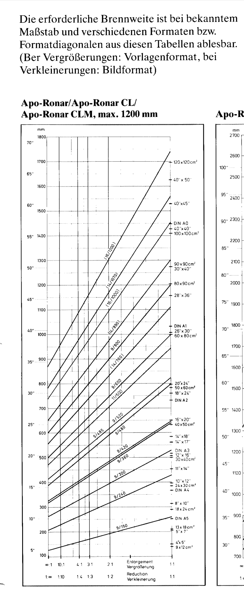

The 16/1000 Apo-Ronar should get you to 5:1 with 20x24" according to Rodenstock. 14/890 Apo-Ronar takes you to 4:1, and the 9/600 not even to 2:1.

Am I right in thinking that a lens that just covers to shoot 20x24 at infinity if used on an enlarger will not project much larger than 20x24 to print
and that its not just a matter of longer bellows
i.e. its the opposite of being able to do macro on a largeformat camera just by adding bellows extension ?
from fotoD's chart above it seems that a 480 app ronar or above will work and is obviously a lot cheaper and easier to find than the longer ones but maybe im missing how this works on an enlarger ?

Look at the bottom scale for enlargement. The 480mm lens only covers if you will print 1:1.
If you look at the 20x24" format (right hand scale) and 3:1 (bottom scale) you'll find that they intersect on the line of 9/800.
That means you can print up to 3x enlargement of a 20x24" negative with the 800mm lens, but no larger (in theory). To print larger you'll need one of the longer lenses.

If a lens covers 20x24 in a camera at infinity, it will project to infinity too. And therefore, at any less projection than infinity, the coverage will be greater than 20x24.
