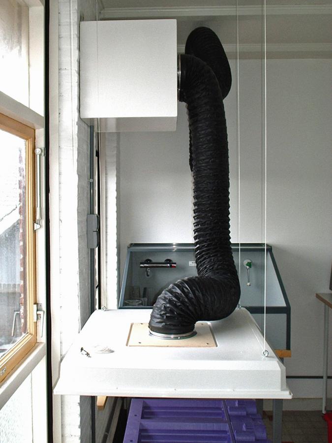

About the ventilation: I have built my own darkroom last year and spent some time in setting up the ventilation.
-be sure there is enough ventilation capacity to refresh the air in the room at least 7 times per hour. For example: i use a 500m3 (centrifugal) fan for a room that is 26m 3. So a lot of capacity, but you always have some losses in capacity because of bends in the pipes for example. Also I use color chemicals, which are worse than B/W, in my opinion.
-The inlet(s) should have a large enough diameter to let enough fresh air in. I use about 2.5 times the size of the outlet. The inlet did not have to be connected to a separate fan.
-I have two local exhaust points, that ventilate close to the source: one above my sink, the other one above the paper processor.

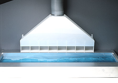

-When you make an exhaust don't allow the air to flow past your face, so no exhaust in the ceiling. For example, the exhaust at my sink is drawing the air from the sink away from me to the back of the sink (at 1.20 meter hight). The best thing you can use is a so called slot hood (see pic). They can be bought but also homemade.
-the exhaust for a paper-processor or dishes should be close to the source (30cm) also. (see picture2)
A lot can be told about darkroom ventilation. Please don't hesitate to ask. When it should not work, its very difficult or too late to change.
Good luck,
Jan-Willem
