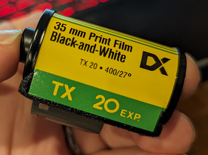

That is an interesting transitional-period roll, being 20 exposures, being DX coded, with the modernized logotype.
