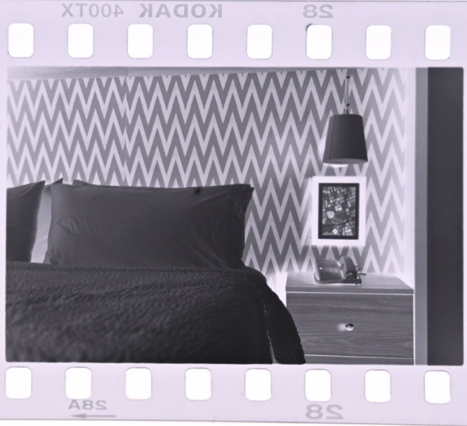

Mixed fresh Xtol and 1:1 developed in a jobo.
Used Kodak rotary times as usual.
So while negatives are a little thin what is strange is the 400TX by the sprocket looks very light gray.
Just purchased a new Fuji C41 fixer and mixed 4:1. Leader test clears in less than a minute and I run it for 6-7
The Xtol smells fine and leader test show it active,
Is it washing of c41 fixer?
Is the c41 fixer taking some of the dies and making the sprocket print gray?
Any ideas?
Please show an example; I can't visualize what "the sprocket looks very light gray" means.
Also, is this on the still wet film or after drying?
If you mean the writing on the edge of the film, that can vary in density coming from the manufacturer. As in, sometimes, it develops very dark or sometimes less dark, using the same development. If the photos themselves are fine, then everything is probably fine. It's very unlikely the fixer ate some of the developed silver unless you left the film in the fixer for a long time.

The density of the edge printing isn't a reliable indicator of development, except perhaps if you have two rolls to compare from the same film batch that you bought at the same time and stored under the same conditions.
As @Don_ih indicated, there can be minor differences in the density right out of the factory.
More importantly, the edge printing is simply normal exposure to the film, done at the time that the film is finished/confectioned.
It then stays as a latent image on the film through the processes of packaging, shipping, retailing and whatever else happens to the film before the film is developed.
In contrast, the images you expose on the film are usually placed there shortly before development.
Latent images can fade over time.

I can not see the dye with my eye.
The digital camera somehow sees it. I changed water in the Jobo like usual 5 times for 2 minutes and did not see any purple in the last 3 waters.

Going by what @MattKing says, are you referring to the edge print? I.e. this bit here:
The 'sprockets' are the little cogwheels in the camera that transport the film; the sprocket holes are the holes on the film that the sprockets latch into.
The negative as such looks solidly developed; it certainly doesn't look underdeveloped.
Keep in mind that the latent image on film isn't perfectly stable; it fades. The edge print is in fact an image that's exposed onto the film in the factory. Hence, it's as old as the film. If your film is a few years old, the edge print has had all that time to fade. Moreover, as @MattKing said, there's no fixed standard for how dark the edge print is supposed to be.

There's no relationship between the exposure of the film and the exposure of the edge markings as the latter are done in the factory and are only for identification (and not for sensitometry; i.e. their density is not controlled).
Your negative looks OK to me; if there's anything wrong with it, I'd consider this particular image adequately exposed and it may be overdeveloped a bit.
The purple color is unrelated to all this and does indeed wash out with much difficulty. It's harmless. If it bothers you, you could try a 10 minute soak in a sodium sulfite solution (hypo clearing agent), or re-fixing the film in fresh fixer. Both are known to help. I'd personally not bother.
In short, I see no problem; you're doing fine. I wouldn't worry and move on.
@koraks has it right about the developing of those negatives.
And about the edge printing as well.

Negatives look a bit thiner than usual.

And I would repeat - those negatives look well developed, if not slightly over-developed.

from these I'd say normal exposure and development but overfixed.
Why do you think it is overfixed? I taught overfixing needs hours to make a difference.
because exposure looked OK to me and due to the dense highlights, development seems at least normal if not over. So, only overfixing seems left. As far as a cure,more exposure or more development seems to be out.
but overfixed.
No way. It's virtually impossible to overfix film and it would take HOURS in a normal fixer to get there and even then the effect would be virtually be insignificant.
You're right; ignore the overfixing tangent; it's nonsense. Sorry to be rude about it, but it really is.
