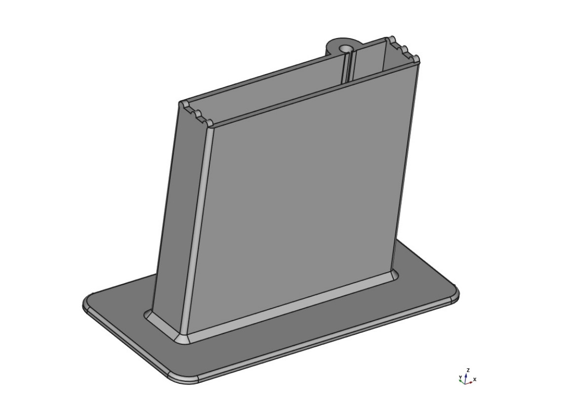

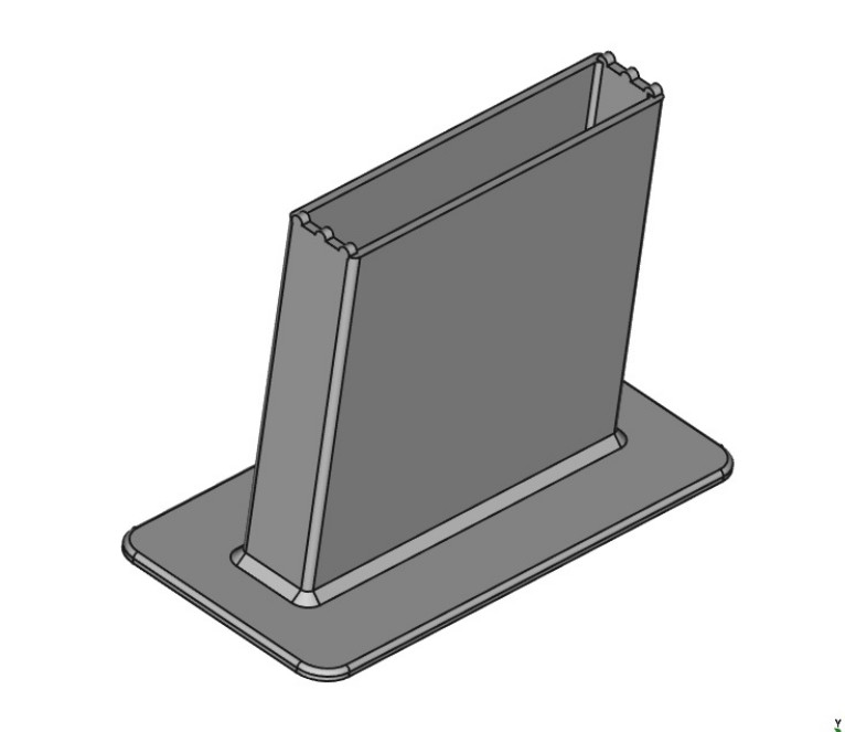

Here are 2 tanks I've just finished for those who only want to shoot and develop a couple sheets of 4x5 film and develop using hangers. Ideal for X ray film developing without fighting scratches. Takes a wee bit over 400ml of liquid to cover the hangers. A little absurd maybe, but I'm sure there's cheapskates like me who don't want to waste Rodinal. These are stl files, not godes. Open in your favorite slicer for your own printer. No copyright, no payment. One tank has a thermometer holder that is exposed to the chemical, but won't tip over in it..

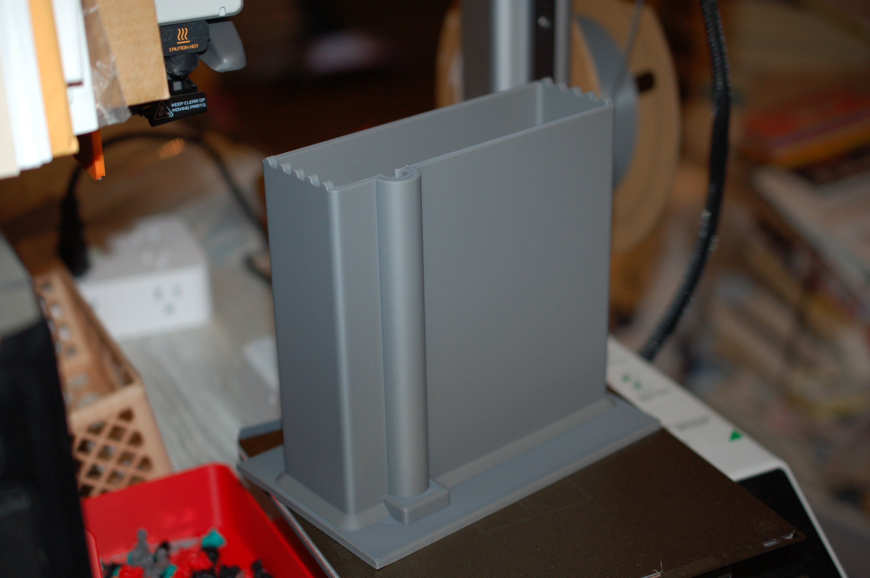

I like the idea! I don't mind reusing stop bath and fixer but prefer to use fresh developer for each processing cycle.
[edit] I have the Bambu A1 Mini and had to trim off some of the supports on the sides of the tank so it could build on my little plate. Starting the build now, will follow up with a picture when done.
[edit2] The .stl files have 4 notches, did you mean to post some with just two notches?
[edit 3] See attached photo, great way to "use" odds and ends of filament.
