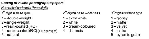

mnemosyne

mnemosyne
Jan 19, 2011
759
Europe
Such a generic classification is not particularly useful if someone asks about the difference between two Foma papers.
Just by looking at the classification table, it might seem as if e.g. the 132 and 532 papers are very similar, just having different 'base types'. In reality, both the base colour and the surface structure are completely different.
Sorry if I gave the impression this table would answer all the questions, it was simply meant as an additional info to decipher those numbers.
I absolutely agree the numbers should not be interpreted too strictly, e.g. one should not be fooled into thinking that surface "2" will always represent exactly the same type of surface structure across the different paper product lines (RC/FB, WT/NT ...)
