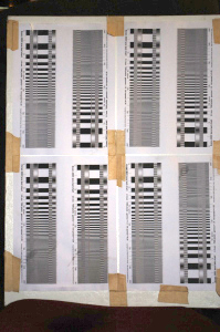

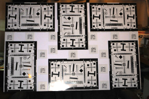

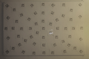

My test target(s).
The first is plain paper prints on canvas board, calibrated a lot of rangefinders with this one, 2 and 3 are glossy prints on foam core. These take the guesswork out of focusing problems.
